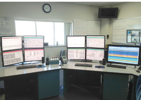

Unlike the software upgrades that are invisible to the operator, the monitor screen graphics used by the technicians to operate the plant are personalized to meet the plant’s unique needs. Siemens duplicated the dozens of existing graphical screens of the human-machine interface so well that it took a sharp eye to recognize the differences. Many additional graphic monitoring and alarm screens on 24-inch monitors were added once the operators became familiar with the significantly increased capabilities of the T3000 DCS (Figure 3).
3. Operator interface upgraded. The DCS upgrade used the graphic designs from the earlier system to accelerate operators’ familiarity with the new system. Suggestions from the staff, based on almost a decade of operation, were also used in the upgraded DCS design. Source: Lakeland Electric.

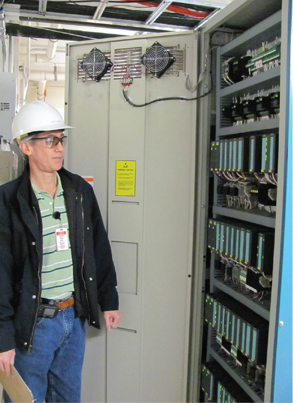

Field hardware upgrades began with Siemens technicians removing all the old cards and then stripping the remaining equipment from the cabinets, with the exception of the original card-edge connectors and card-edge connector wiring. The hardware upgrades were configured such that the new processors, I/O, and other PROFIBUS modules could be used in conjunction with the original card-edge connectors to minimize wiring changes from the field instrumentation to the cabinets. The new I/O modules were tied to the original field wiring by plugging the existing card-edge connectors onto a Siemens-designed interface card.

With the field wiring updated and new DCS cards and components in place, Siemens personnel efficiently made the hardware conversions and performed I/O andloop checks on the combustion and steam turbine trip and protection systems. The subsequent plant startup of the completed DCS was completed without incident (Figure 5). However, the team had to overcome a number of challenges to complete the project on time (see sidebar).
5. Quick cabinet retrofit. The existing field termination cabinets were stripped and restocked with new control hardware, significantly reducing the time required for the retrofit. Electrical & Controls Engineer Scott Fowler noted that a new optical cable was run across the plant to link all the remote cabinets together with the control room. Source: POWER
