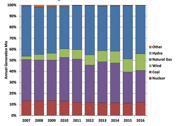

The 1.9-GW plant made up a fraction of the 101 TWh ERCOT’s coal plants generated in 2016. Coal generation made up 28.8% of ERCOT’s total generation mix, which has been shrinking as more natural gas plants and wind farms are added to the grid. In 2016, gas’ share was 43.7%, nuclear generated 12%, and wind generated 15.1% (soaring from just 3% in 2007).
- ERCOT’s annual generation mix. Courtesy: Potomac Economics

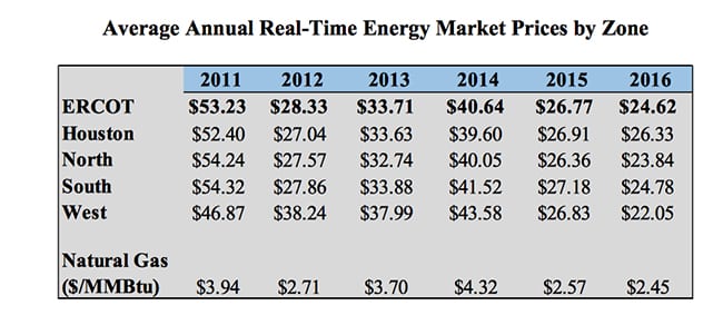

2. The price drift. In its “2016 State of the Market Report” published earlier this year, Potomac Economics, ERCOT’s independent market monitor, said the average annual real-time energy market price decline is largely pegged to “lower natural gas prices and surplus supply.” Courtesy: Potomac Economics
As some experts note, falling wholesale power prices are indicative that competition is functioning as it should. ERCOT’s unique energy-only market is designed so that net revenues from the real-time energy and ancillary services markets alone provide the economic signals that inform generator decisions to invest in new generation or retire existing generation. The market was also designed so that generators should shoulder the risk of building new power plants, and that new power plants produce more electricity per unit of fuel, noted the Association of Electric Companies in Texas.
ERCOT has said that wholesale energy prices have fallen so quickly partly because of the efficiency of its competitive market wholesale market, but they also resulted primarily from “very low natural gas prices,” averaging $2.45/MMBtu, as well as an influx of wind power production. Since 2009, ERCOT’s wind capacity has nearly doubled to more than 17,000 MW and an additional 5 GW may connect to the grid this year based on existing transmission agreements.

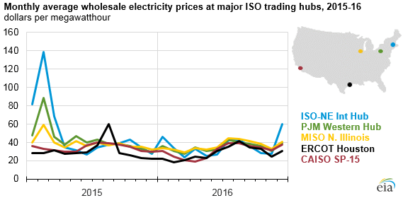

3. How ERCOT compares. Average wholesale power prices at major trading hubs across the U.S. were significantly lower in 2016 than in 2015. This was primarily driven by the sustained low cost of natural gas, a fuel that often determines the marginal generation cost in most power markets. Source: EIA/SNL Energy

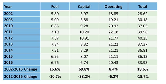

4. U.S. nuclear plant costs (2016 $/MWh). According to a recent white paper from the Nuclear Energy Institute, in 2016, the average total generating cost—factoring in fuel, operating and capital costs—for nuclear energy was $33.93/MWh. The average annual real-time energy market price in ERCOT in 2016 was $24.62/MWh. Courtesy: NEI, Nuclear Costs in Context (August 2017)
