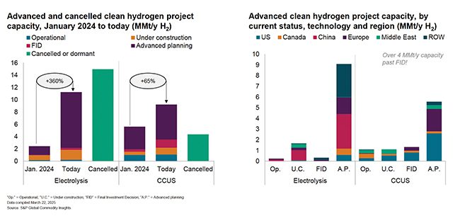

For some years now, hydrogen has been hailed as a critical piece of global decarbonization and a potential link between renewables and reliability. Progress has been tangible: To date, more than 4 million metric tons per year (MMt/y) of low-carbon hydrogen capacity has passed final investment decision globally (Figure 1), Brian Murphy, head of Hydrogen and Low Carbon Gas Research at S&P Global Commodity Insights, reported at the S&P Global World Hydrogen North America 2025 conference in April. But development has been uneven. While China and Europe lead in electrolysis capacity, North America is advancing rapidly in carbon capture, utilization, and storage (CCUS)-based hydrogen. Most global projects remain in early-stage development, though momentum is building as select efforts begin to move through feasibility studies and into execution.
1. More than 4 million metric tons per year (MMt/y) of low-carbon hydrogen capacity has passed final investment decision (FID) globally. While the bulk of announced projects remain in early-stage development, a growing number are now entering advanced planning and execution phases, with North America gaining traction in pathways linked to carbon capture, utilization, and storage (CCUS). Source: Brian Murphy, S&P Global Commodity Insights, Clean Hydrogen in North America, World Hydrogen North America 2025.
