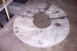

Lagging is the finishing material (steel or aluminum) used to cover many types of insulation, especially those used on the many large flat surfaces within a power plant. Also known as cladding, lagging—without a vapor barrier—ranges in thickness from 0.032 to 0.063 inches (for aluminum) and from 20 gauge to 16 gauge (for steel). Generally, the installation of lagging is a custom job tailored to the equipment configuration (Figures 3 through 6).
3. Hot to trot. Typical burner front before insulation is applied.Courtesy: Gary Bases
4. Access required. Removable ceramic fiber blankets for burner fronts being fabricated.Courtesy: Gary Bases
  5. Boarded up. Burner front with Class 4 mineral wool boards installed. Courtesy: Gary Bases
  6. Ready for fire. Complete insulation job on a typical burner front.
What does lagging do? First and foremost, it protects the insulation it covers by adding a flat and even surface layer. Lagging must be stiffened and fastened on adequate centers to prevent excessive deflection or "oil canning" when hot or cold.
The second purpose of lagging is weatherproofing. Properly installed flashings, slopes, and seals ensure total water run-off and prevent ponding or accumulation of water. Lest you think that lagging is only needed outdoors, remember that power plants regularly water-wash their indoor boilers and equipment. Water is the enemy of any insulation system, regardless of its location.
