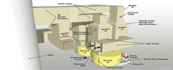

Mercury (Hg) enters the scrubber (Figure 2) in both the oxidized and elemental forms. In order for it to be removed in the scrubber, the Hg must be oxidized and then precipitated to solids. In regular operation, some oxidation occurs, however, help is needed in order for the process to meet MATS requirements.
2. Coal Creek scrubber overview. The plant currently scrubs 85% of its flue gas in both units, but by 2017 it will have to scrub 100% in order to meet regional haze requirements. Courtesy: Great River Energy
