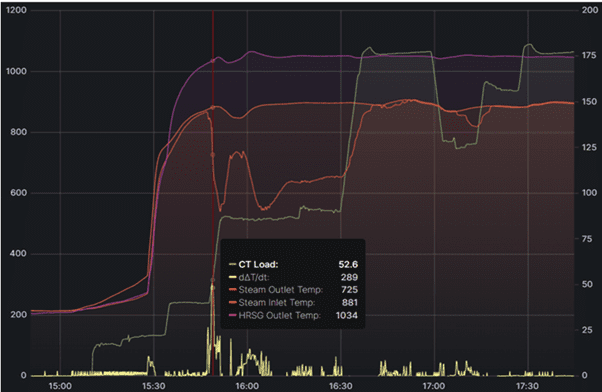

Similarly, predictive maintenance predominantly relies on actual operating data rather than asset runtime alone. Though the technology may record an abundance of data, more scrutiny may be placed on the tools used for collection and not the underlying trends they should uncover. But, to an extent, this is expected. The sheer volume of data points that can be tracked, including—but not limited to—temperature, pressure, vibration, and acoustics, can lead to a push to add even more sensors and gather more information despite the wealth of relevant metrics already available. The challenge, therefore, lies not in gathering more information but in accessing and interpreting this data effectively (Figure 1).
combined-cycle-power-plant-operating-trend
1. Acquiring plant operating data is fairly routine. Gleaning insight from the data is more difficult. Courtesy: IMI Critical Engineering
