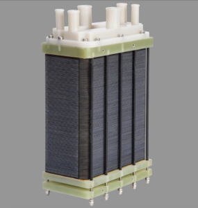

Some developers are now turning to solar-grade silicon. Using mature fabrication processes from the solar and microelectronics industries, developers can create stacks with micron-scale flow fields, thinner components and more uniform reactant distribution. These stacks are lighter, more compact and more resistant to harsh operating environments.
Third-party testing is starting to confirm these advantages. In one recent evaluation by TÜV Rheinland, a silicon-based 150-kilowatt fuel cell stack achieved power densities of 9.8 kilowatts per liter and 9.7 kilowatts per kilogram. These results weren’t theoretical, they came from full-scale, production-ready systems designed for real-world applications.
