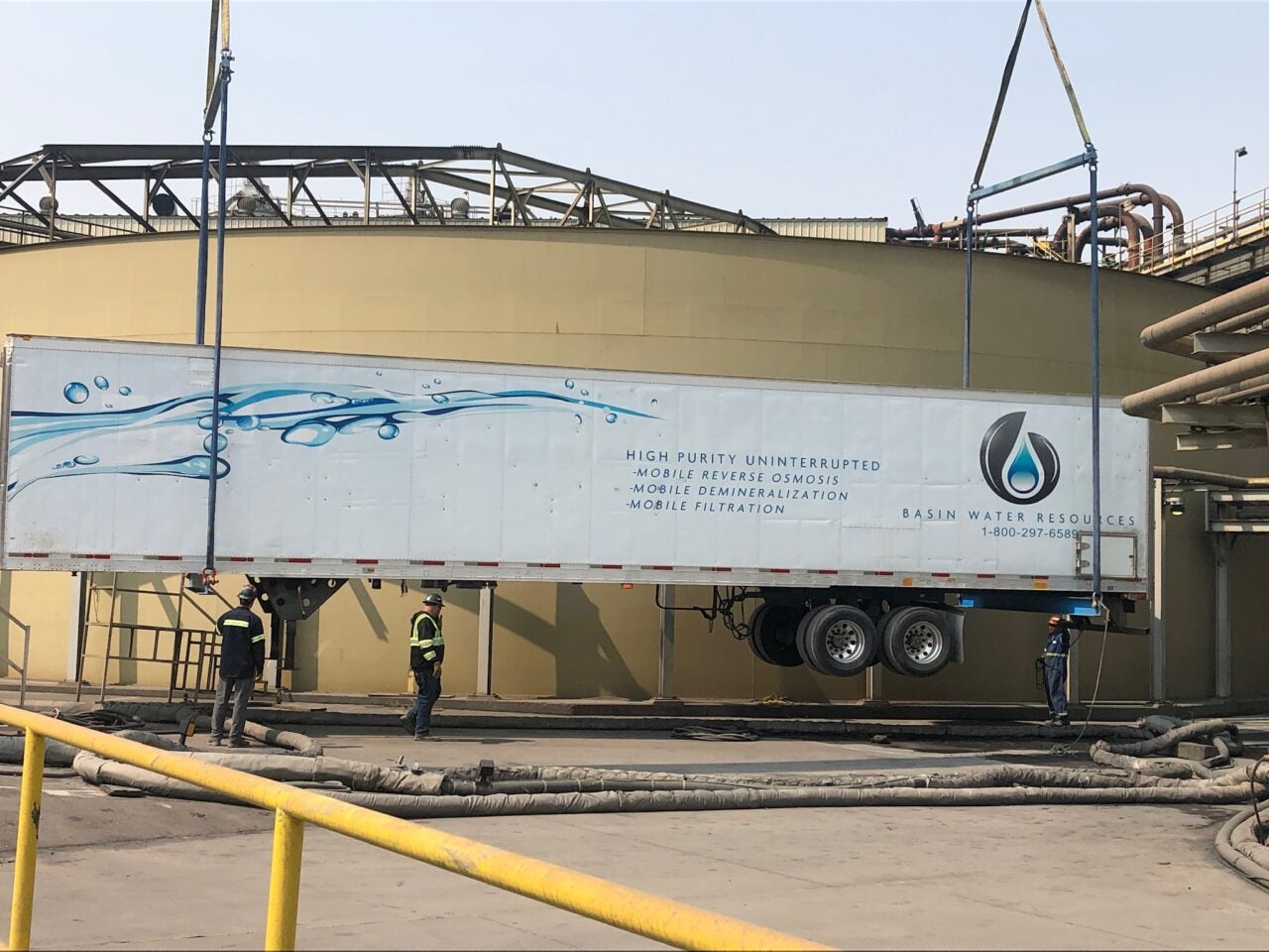

The location of the temporary WTP should be easily accessible to all required utility connections, both power, and water. The location should also be able to support the weight of the equipment. Placing equipment directly on any unstable ground is a recipe for disaster and should be carefully examined prior to placement. At the sign of any rain, the equipment will sink. Hard pipe such as HDPE poly pipe will be stressed and could damage connected equipment.
We always recommend the first connection to any temporary equipment be a flexible hose to provide for any expansion or contraction that takes place. Secondary containments may be required by the facility and an area of 12’ x 60’ should be required if this is the case. If a suitable foundation cannot be located, cranes and special rigging can be used to place the equipment in an ideal location.

WTP rental companies provide rental equipment but don’t usually include installation. While rental companies have qualified service technicians, they don’t typically have plumbers or electricians on staff for mobile water treatment equipment installs. While not always possible, a site walk-down is tremendously helpful as a part of a contingency planning visit before the use of any temporary WTP. Some installations are as simple as a few pieces of 3” hose and others require several pieces of equipment and thousands of feet of pipe.
