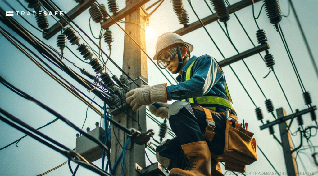

Workers are aware of the hazards caused by electrical energy and are often wary, but since the danger is ever present, it can be taken for granted and they become complacent around it. The use of personal protective equipment (PPE) can help keep them protected at all times (Figure 1) and the implementation of a successful PPE program will result in not just a safer workplace but more efficient operations.
1. Power company workers are exposed to many hazards, including the risk of electrocution. Courtesy: TRADESAFE
