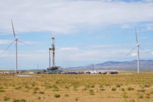

Fervo Energy recently drilled a 15,000-foot geothermal well in just 16 days, with a max average rate of penetration (ROP) of 95 feet/hour (29m/hr), 79% faster than the DOE’s baseline for ultradeep geothermal. Previously, the company’s Project Red pilot reached a record flow rate of 107 kg/s, achieving performance once expected to be at least a decade away.
These advances are driving down the levelized cost of electricity (LCOE) for geothermal. Fervo’s latest wells come in under $5 million each, compared to $13 million just a few years ago. At scale, that brings LCOE into the $70/MWh range, which is competitive with nuclear, gas with carbon capture and storage (CCS), and many long-duration storage solutions.
