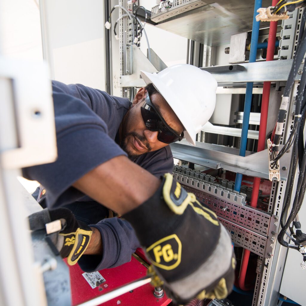

Hiring the right people to perform maintenance must be part of the strategy for an owner of power generation assets. Source: Pearce Renewables
It’s complicated. Getting bogged down in the day-to-day of hiring, training and managing talent can be a risky distraction for asset owners, steering their focus away from their number one priority: performance and production of the solar asset. It’s especially challenging when the asset resides in remote, or less desirable locations. Yet, ensuring preventative and corrective maintenance is mission-critical to the asset’s performance. And that requires highly trained people with superior technical and safety skills.

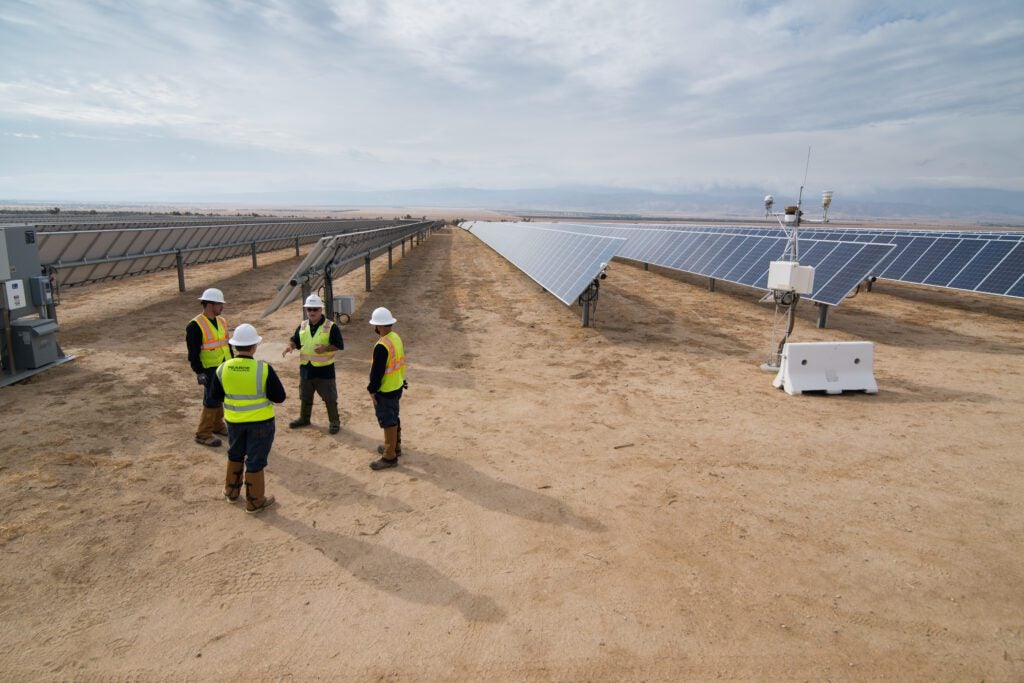

Workers meet to discuss the operations and maintenance of a solar array, an important part of ensuring smooth performance. Source: Pearce Renewables
Choose an EPC with a reputation and history of delivering quality projects on time and on budget. Be sure to have a 100 percent complete site design before entering into the EPC contract. Don’t leave the final details to chance—that’s where panels get installed and where the wiring and cabling takes place and where many O&M nightmare begin.
That’s because some EPCs normally employ a handful of experienced in-house professionals and outsource a lot of the labor to install panels and wiring. When it comes to labor, make sure the EPC isn’t picking cheap over quality.

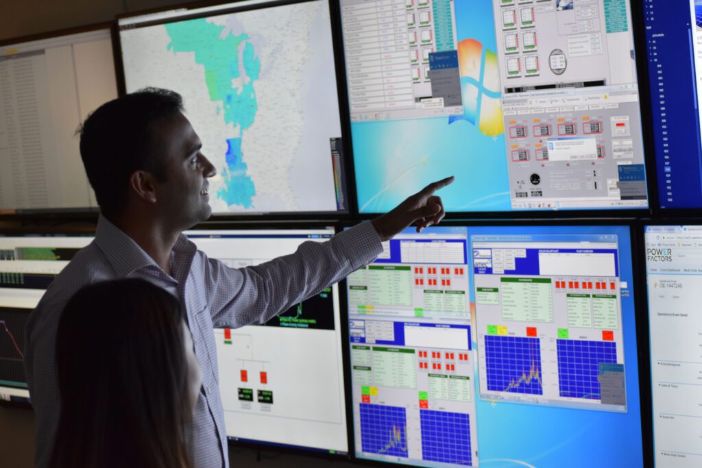

Control centers support remote operation of a power generation installation. Automated condition monitoring can give operators full-time visibility into a site’s performance levels. Source: Pearce Renewables
Automated condition monitoring gives Pearce 24×7 visibility into any site’s performance levels, identifying inefficiencies and performing data analysis to pinpoint the root cause of a problem. Analyzing and diagnosing a challenge remotely without sending a technician to the job site to assess the situation helps manage cost. And it accelerates the ability to get a project online faster, significantly reducing downtime.
Condition monitoring systems are making O&M servicing smarter and more efficient. Armed with data about the exact point of failure—whether a dirty filter panel, a faulty PV connector, or a malfunctioning inverter—the asset owner or their outsourced O&M service provider can deploy a technician with the right knowledge to exactly the right place to resolve the problem faster.
