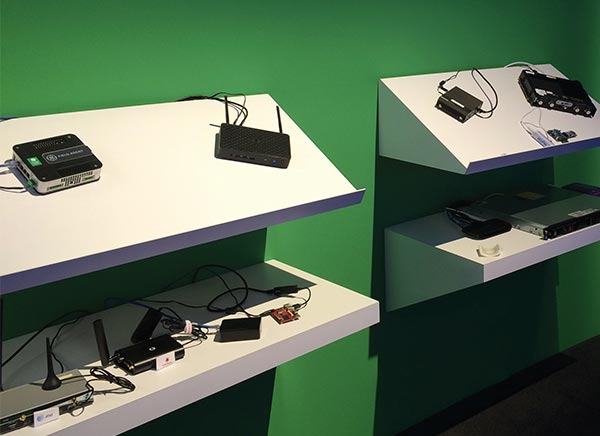

4. The promise of Predix. These Predix-ready devices were on display at Minds + Machines. GE’s Predix platform promises to connect power generation to the Industrial Internet to enable more robust data management, analysis, and decision-making. Source: POWER/Gail Reitenbach
In one of his M+M presentations, Bell explained that Predix can run in a box on site (Figure 4), in the cloud (see “Using the Cloud for Speed and Scale”), or as a platform that bridges the OT and IT divide.
