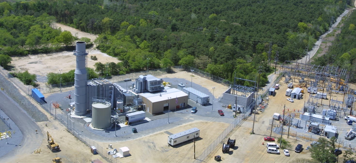

The Brentwood site was chosen by NYPA because it is a single-unit site in a relatively remote location. The plant’s location and layout, combined with its relatively low capacity factor as a peaking unit, facilitated the temporary modifications required for the demonstration project. In addition to having the technology of interest for testing, the Brentwood plant also had the space and logistic support needed for hydrogen delivery and storage while testing.
