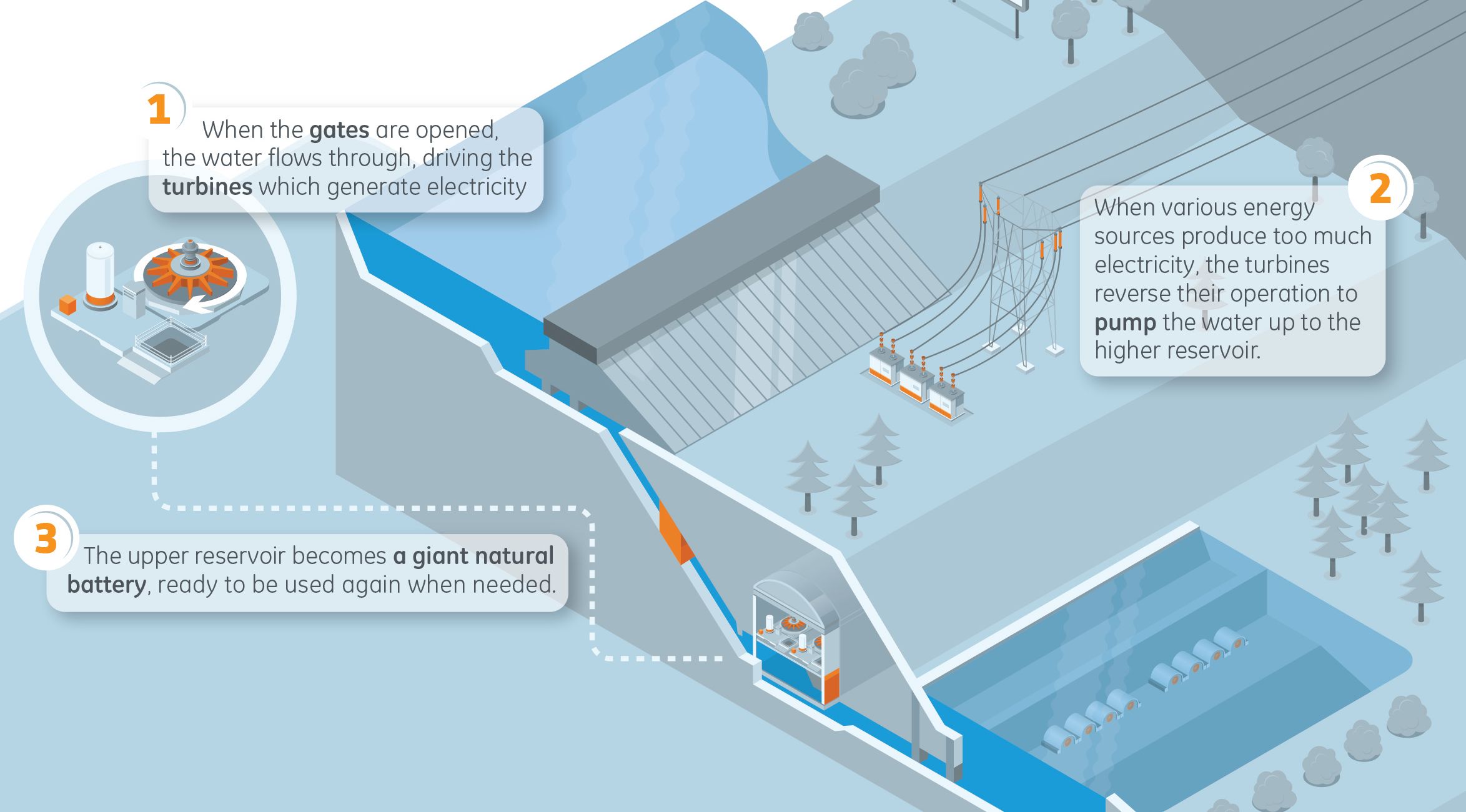

1.         Pumped-storage hydro functions to store energy by pumping water from a lower reservoir to an upper reservoir when excess electricity is available. When the energy is needed, the water is released from the upper reservoir and directed through turbines to generate electricity. Courtesy: GE Vernova
