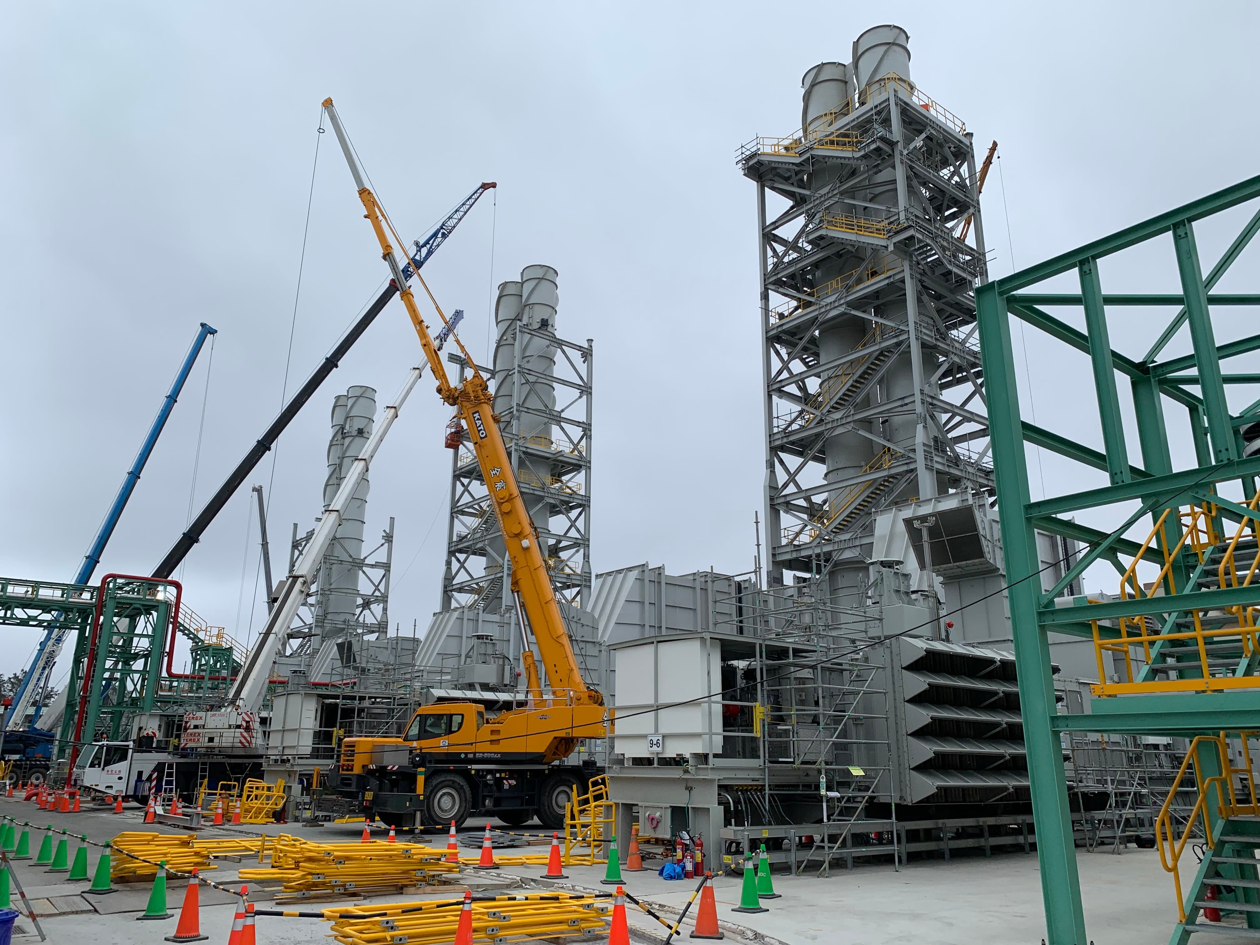

10-Month Construction Timeline
Construction of the Tung Hsiao project was completed within 10 months (Figure 1). It’s notable that GE Vernova—active in Taiwan since 1961—has more than 30 gas turbines installed on the island, providing about 6 GW of power generation capacity. The company has said it supports “Taiwan’s 5+2 Industrial Innovation Plan, which focuses on seven industries and projects that can promote innovation, create high-income job opportunities, and support balanced development in high-value business sectors.”

1.         Construction of the Tung Hsiao Power Plant Renewal Project took 10 months, from February to December 2022. It is one of several projects in Taiwan that are using or will use equipment from GE Vernova. Courtesy: GE Vernova

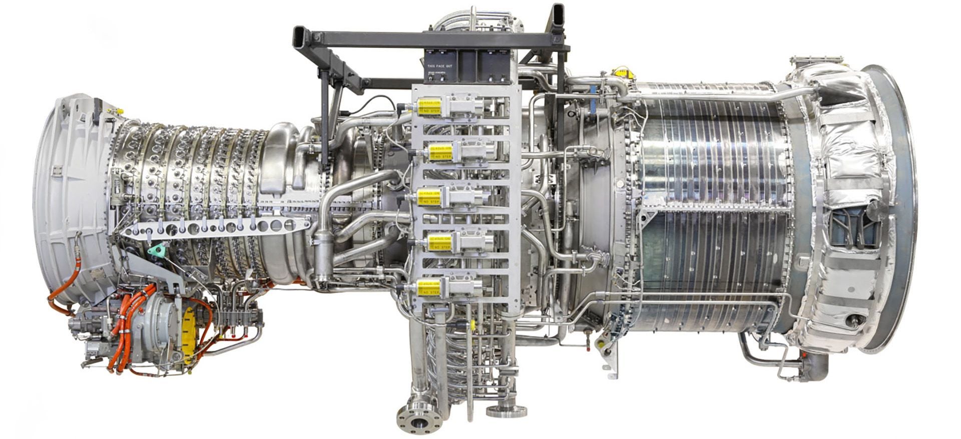

The new units at Tung Hsiao can go from startup to full load in as few as eight minutes. They already are capable of burning a fuel blend containing as much as 35% hydrogen, with the expectation that will increase to 100% capability over this decade.

2.         The GE Vernova LM2500XPRESS aeroderivative turbine, part of the company’s line of LM2500 turbines, is designed for high efficiency. It helps reduce operating costs and plant emissions. The turbine has dual-fuel capability, and has the company’s latest dual-fuel dry low emissions technology. Courtesy: GE Vernova
