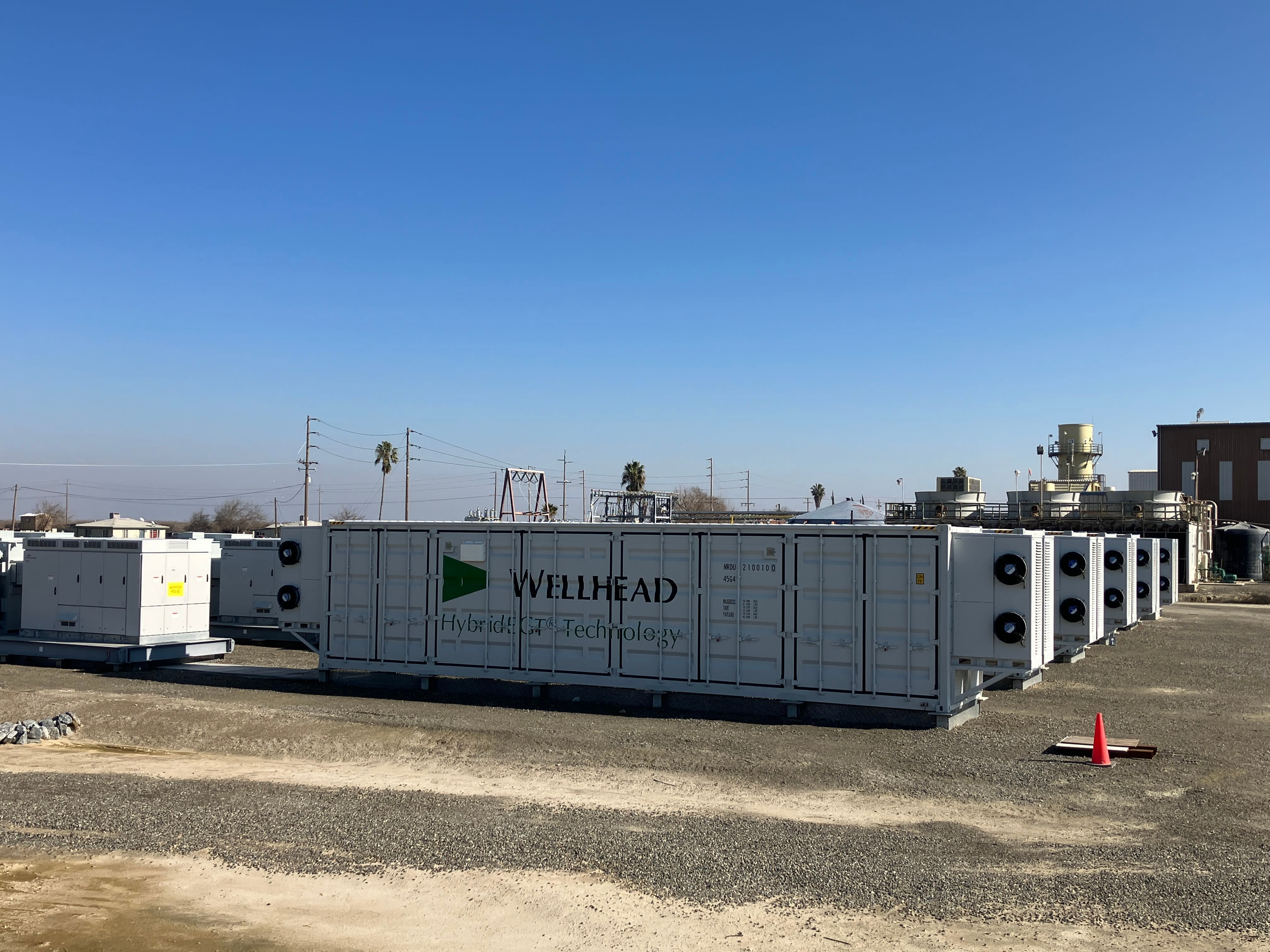

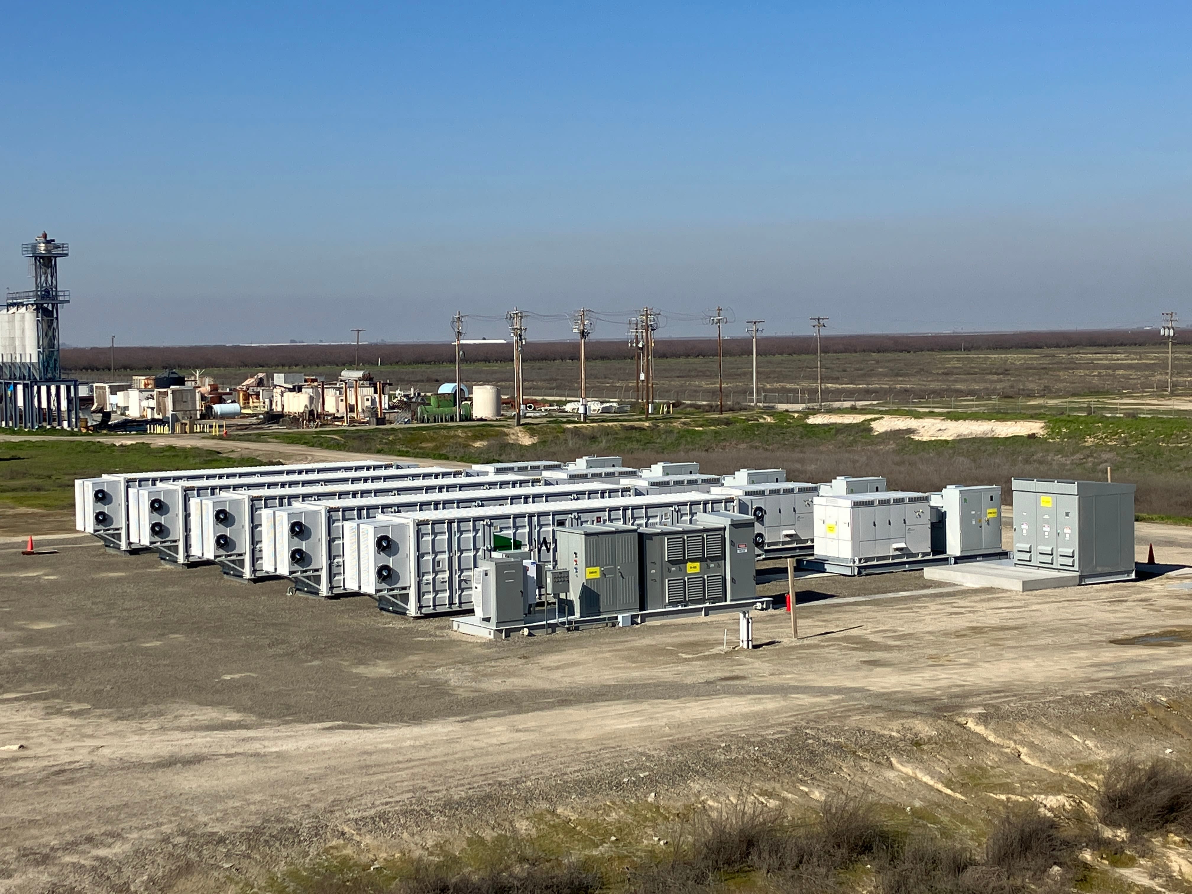

The Fresno Hybrid, located in Fresno, adds 16 MW of battery energy storage to the existing 48-MW gas-fired plant. In the process, it enables the plant, which came online in March of this year, to burn significantly less fuel than a standard gas-fired site, and it has improved local air quality by reducing particulate emissions from the facility by as much as 78%.
MCE created the hybrid project in partnership with Wellhead Power eXchange, part of Wellhead Electric Co., using Wellhead’s Hybrid Electric Gas Turbine (EGT) technology (Figure 1) that was co-developed with General Electric. The battery shortens the amount of time the natural gas plant is operating, and increases the quality of the plant’s reliability services, which support wind and solar generation. The integrated battery storage system, operated by proprietary software, provides an array of reliability benefits that neither turbines nor batteries can provide on their own.
1.         Wellhead’s 16-MW/16-MWh hybrid Electric Gas Turbine (EGT) battery system provides an economic pathway to speed up the energy transition while maintaining grid reliability. The EGT increases efficiency, reduces emissions, and achieves high-speed performance. Courtesy: Wellhead Power Solutions
