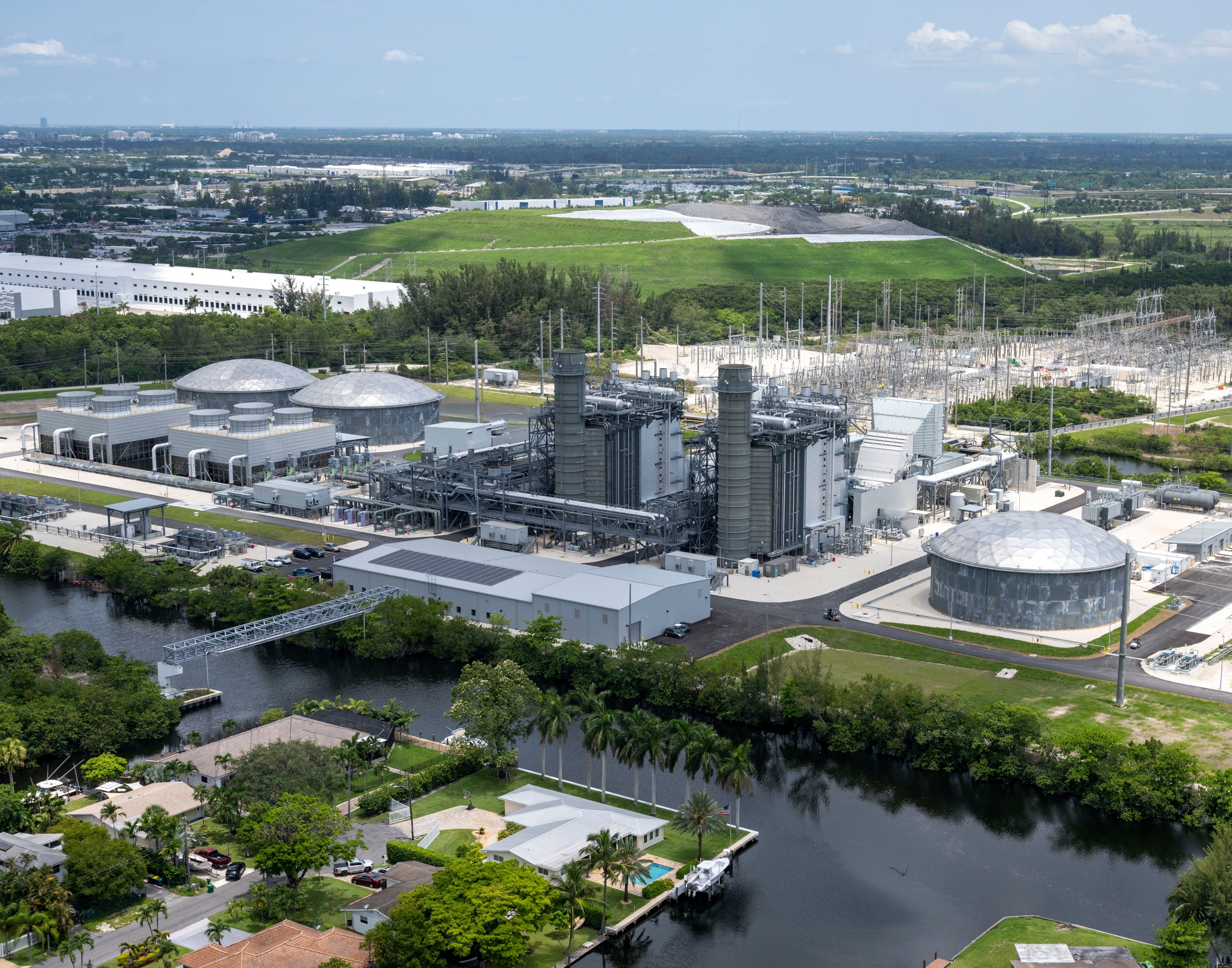

Florida Power & Light’s Dania Beach site has been producing power for Fort Lauderdale, Miami, and surrounding communities for more than 95 years. With the latest modernization project, it’s destined to provide power to the area for many more years to come.

Florida Power & Light Company (FPL) was created on Dec. 28, 1925. In its first year, the company served approximately 76,000 customers in 58 communities. FPL’s first power plant was the Lauderdale Plant, which was constructed on a site located along the coast at nearly the midpoint of the Miami-Fort Lauderdale-Pompano Beach metro area. The location has remained a power generation resource for FPL ever since.
The first repowering of the Lauderdale Plant took place in 1957 when more modern (for its time) conventional steam turbine and boiler technology was installed. Two banks of 12 simple-cycle gas combustion turbine units were added to the site in 1970 and 1972, respectively, giving the site more than 1,000 MW of additional peaking capacity. In 1993, the Lauderdale Plant was repowered again, this time with two 2-on-1 combined cycle generation units adding more combustion turbine generators to the site mix.
The recent modernization of the Lauderdale Plant into what is now known as the Dania Beach Clean Energy Center continued FPL’s commitment to bring the most efficient and cost-effective generation to its customers. The project transformed what had over the years become the company’s least-efficient combined cycle power station, into what is now FPL’s most-efficient plant.
The Dania Beach plant is a state-of-the-art 2-on-1 combined cycle unit. The new unit’s heat rate represents a 22% improvement over the approximate 7,800 Btu/kWh heat rate of the previous Lauderdale Plant. This results in significant fuel savings for FPL customers. Dania Beach uses natural gas as its primary fuel, leveraging the existing gas pipeline to the site. In the unlikely event of an extended disruption to the natural gas supply, Dania Beach is also designed to burn light fuel oil with an ultra-low sulfur content as a backup fuel.
FPL has said Dania Beach enhances its system reliability by improving the load-generation balance in the southeastern Florida region of the company’s service territory. Beyond the fuel savings, system reliability improvements, and air emission reductions, Dania Beach is estimated to generate significant economic benefits, including millions of dollars in tax revenues for local governments and school districts, and a number of temporary and permanent jobs.
A Well-Executed Project
FPL signed an agreement with Black & Veatch to perform the engineering, procurement, and construction (EPC) contract work for the Dania Beach modernization. FPL, consistent with its typical process, procured the steam turbine generator and heat recovery steam generators directly. Repowering the existing site allowed reusing several existing energy systems at the location. No new offsite power transmission lines or electric substations were needed, and no new natural gas pipelines were required.

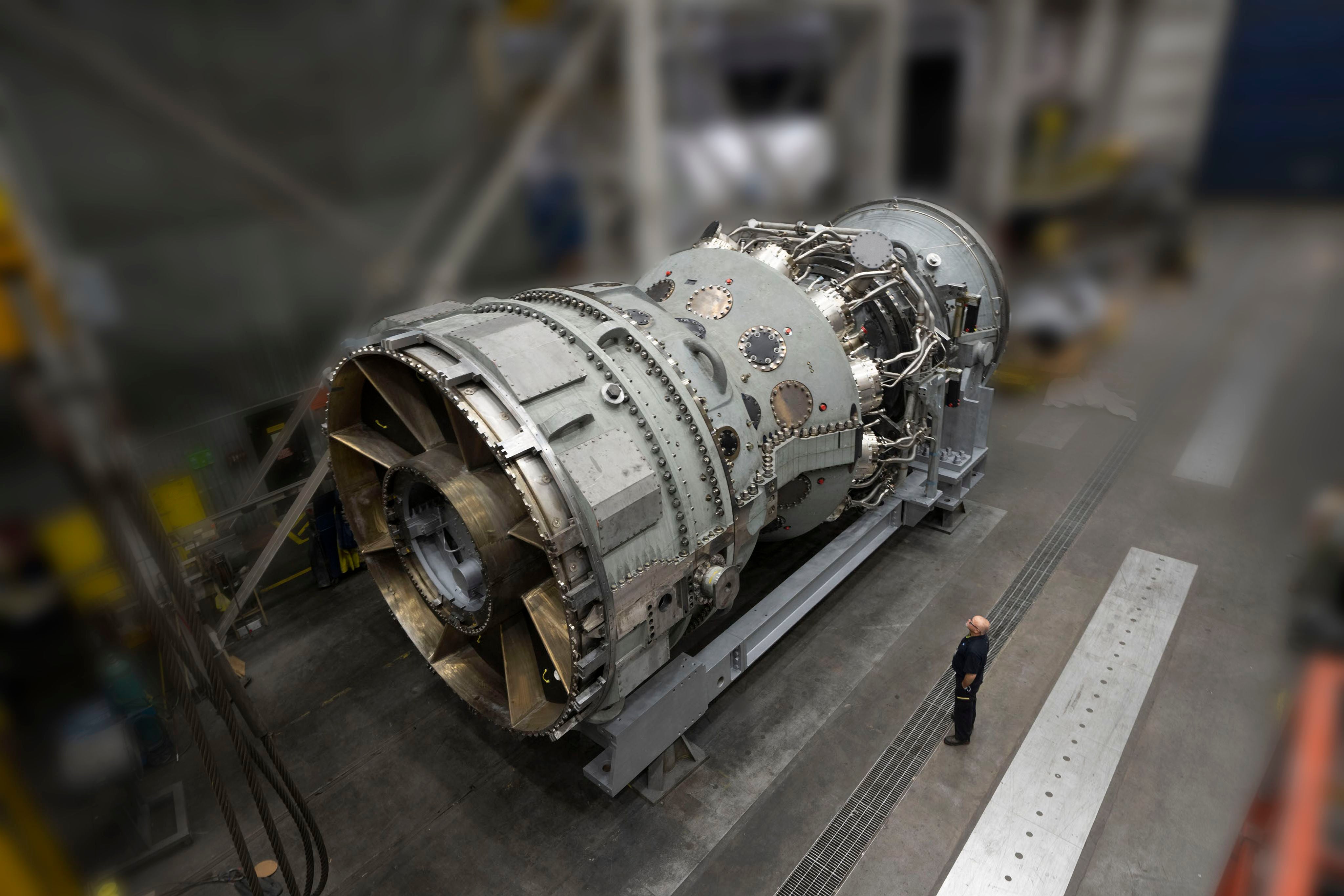

The Dania Beach GTs are GE 7HA.03 models (Figure 1). The 7HA.03 is a larger version of GE’s 60-Hz HA platform. It is very similar to the 7HA.01 and 7HA.02, which came before it, but the 7HA.03 has larger compressor and turbine sections, allowing for greater air and fuel flow, which results in more power output than previous 7HAs.
The 7HA.03 has a simple-cycle net output of 430 MW—a sizable boost compared to its forerunner, the 7HA.02, which is rated at 384 MW, and the 7HA.01, which is rated at 290 MW. The 7HA.03 in a 2-on-1 combined cycle configuration—as is installed at Dania Beach—has an output of 1,282 MW.

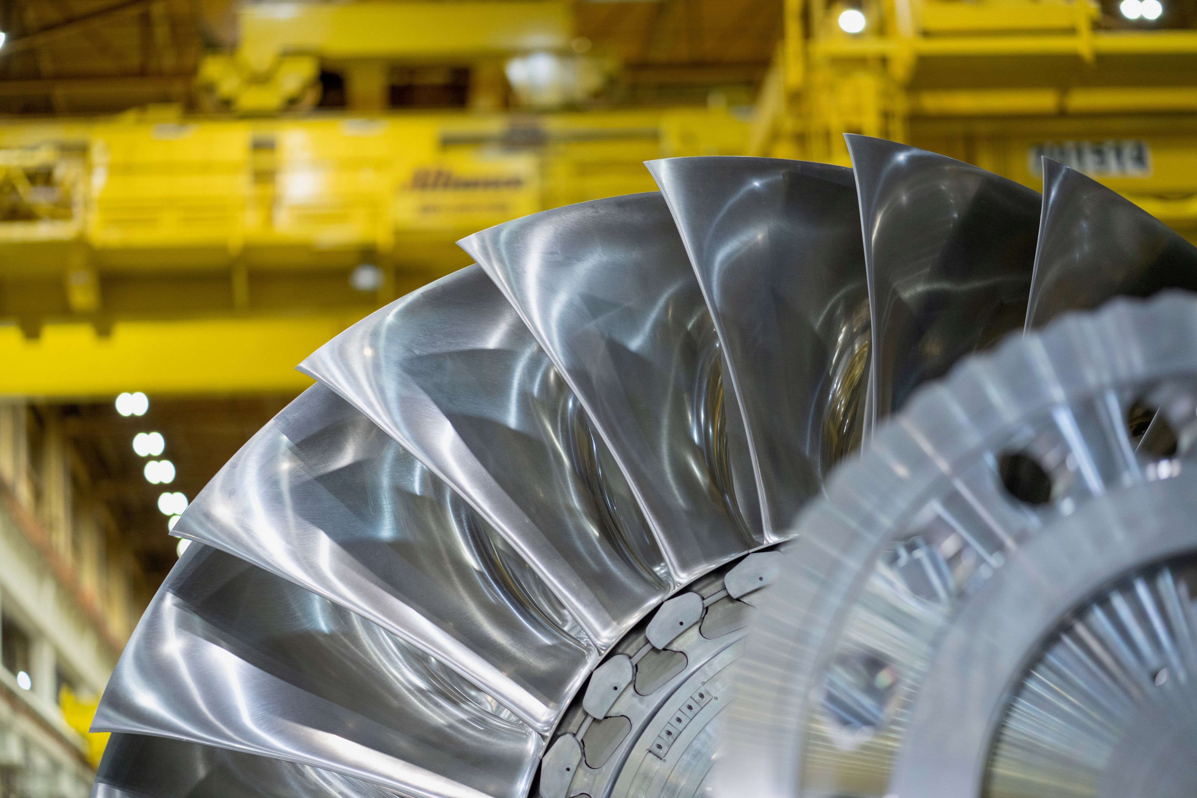

1.         The 7HA combined cycle plant ramps up to full load in less than 30 minutes and features a novel configuration that supports simplified installation and maintenance. Courtesy: GE Vernova

The Dania Beach GTs are incredibly flexible, with an emissions-compliant operating window of 80 MW to 430 MW. The Dania Beach GTs are the only two 7HA.03s (Figure 2) currently in commercial operation, but there are 14 others on order and another 10 have been tech-selected for other clients’ projects.
2.         According to GE, the 7HA.03 gas turbine is the most-efficient and highest-capacity 60-Hz gas turbine currently installed in the world. Courtesy: GE Vernova
