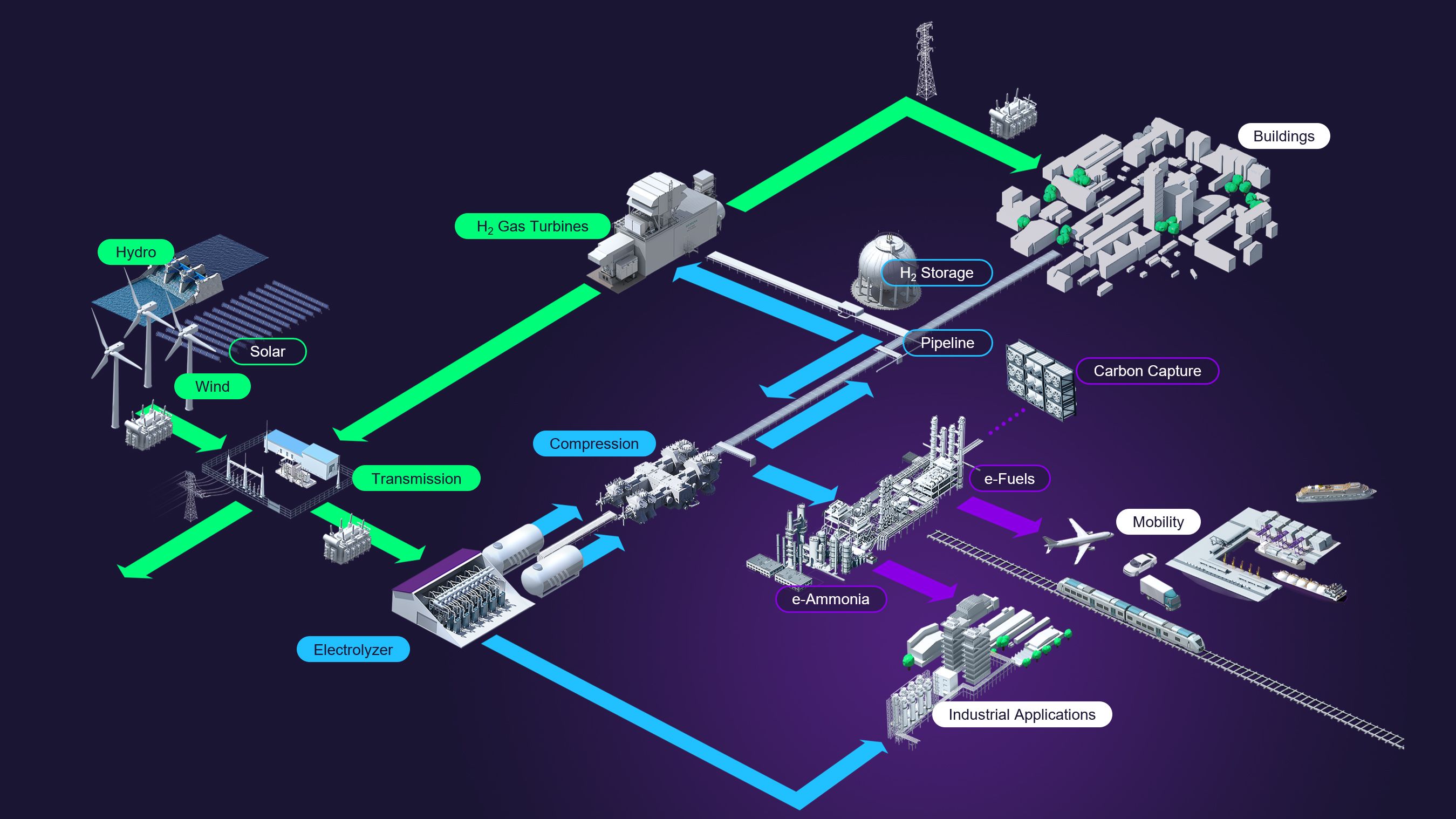

Still, hydrogen-ready gas turbines alone don’t make up an entire hydrogen economy. What is lacking is infrastructure (Figure 1), and more specifically, production capacity for hydrogen. Due to this scarcity, prices are still high. Likewise, sufficient hydrogen pipelines, transportation capacity, and storage facilities are lacking in most places. And where companies are pushing for building the necessary infrastructure, another hurdle exists—the permit process is lengthy and difficult in the U.S. and in other countries.
1.         Additional hydrogen infrastructure is needed to fully capitalize on the benefits of green and blue hydrogen. Courtesy: Siemens Energy
But that doesn’t mean the industry is idle. On the contrary, pioneering hydrogen infrastructure is being built virtually all around the globe. In the U.S., for example, existing hydrogen infrastructure will be expanded. This includes building out six to 10 clean hydrogen hubs, supported by up to $7 billion from the federal government. Part of this expansion includes work on the existing U.S. Gulf Coast hydrogen network, one of the largest in the world, spanning approximately 300 miles from Freeport, Texas, to Lake Charles, Louisiana.

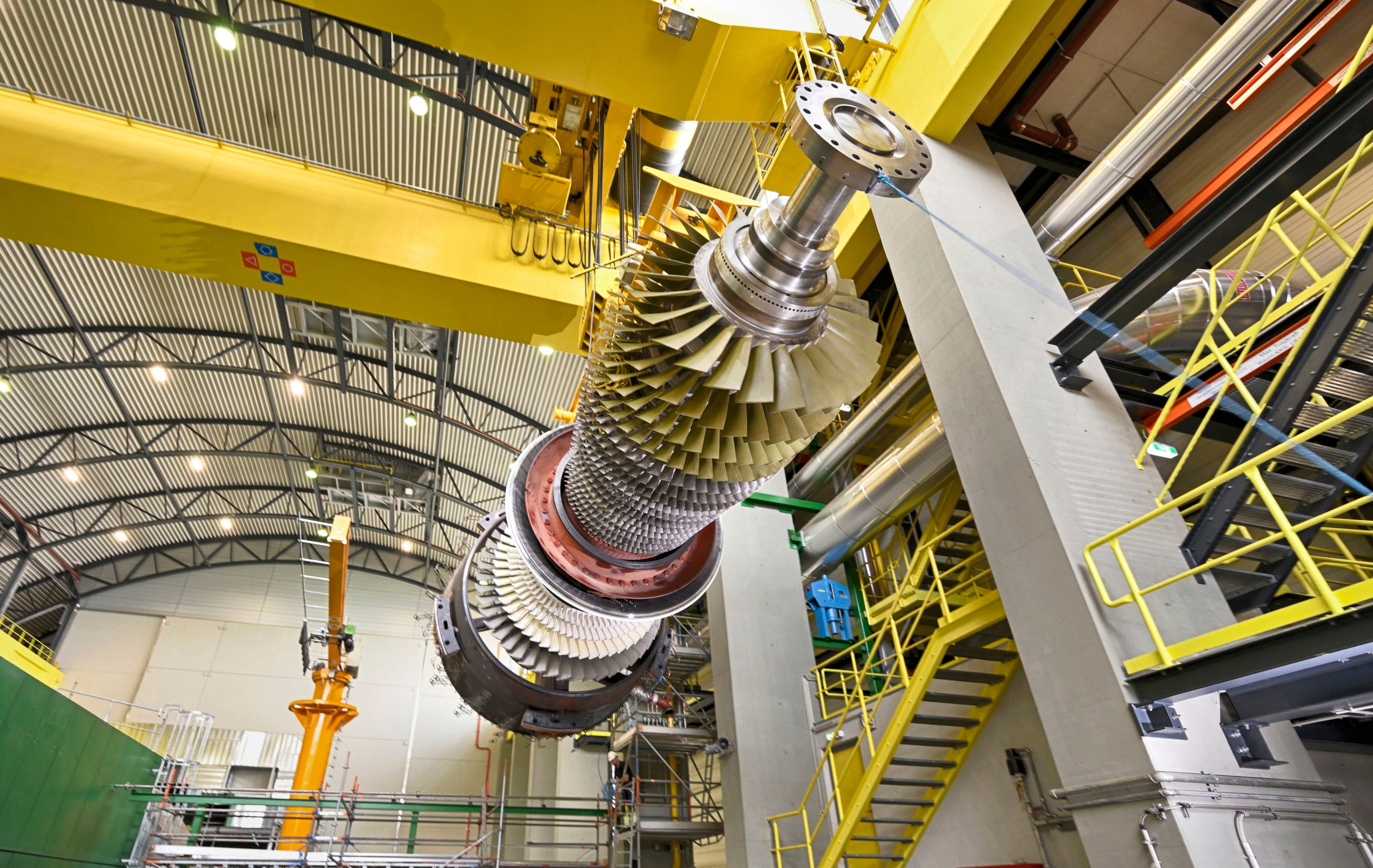

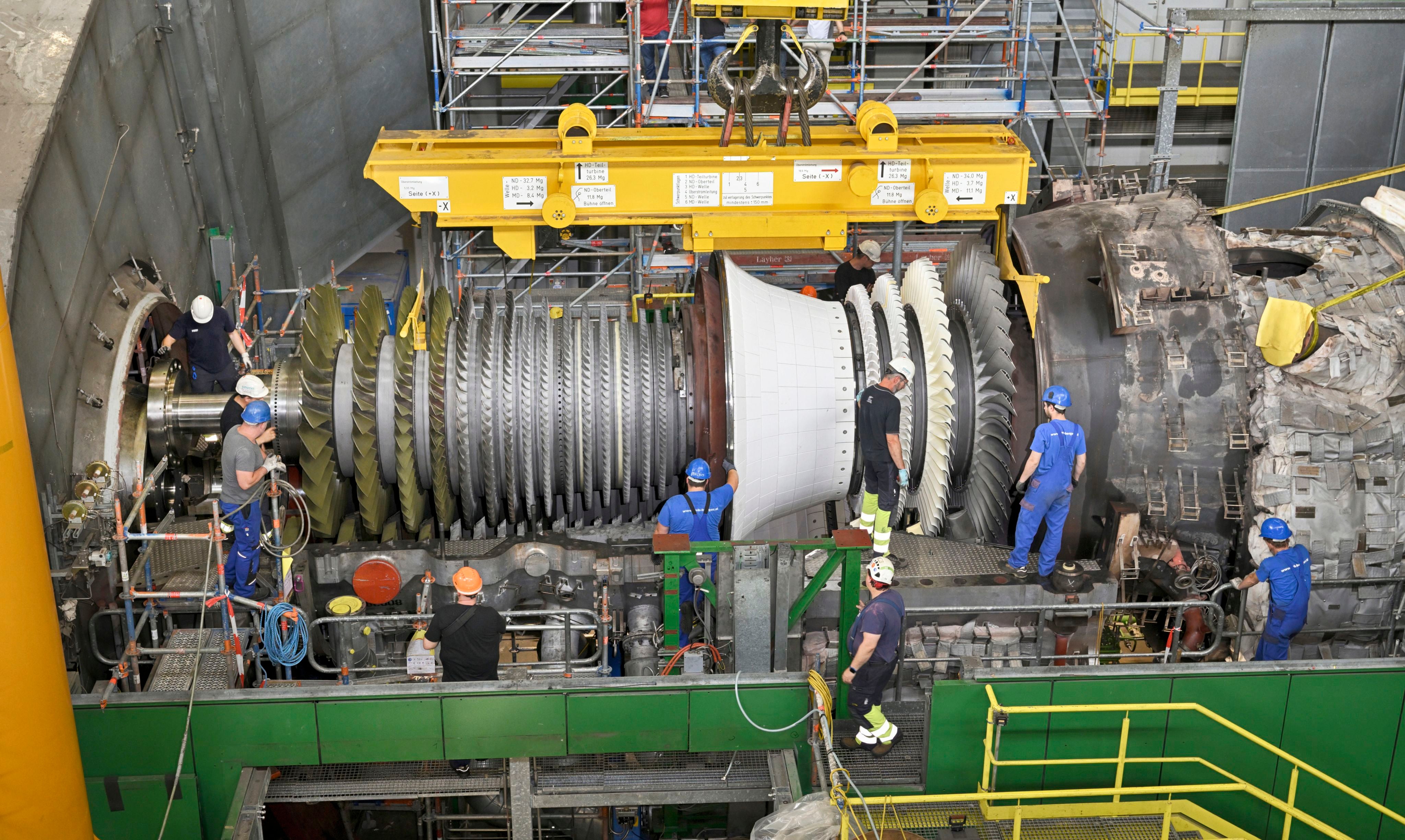

So, it is unsurprising that the groundworks for the re-electrification of hydrogen are already being laid down. There are smaller demonstration and pilot projects, such as Hyflexpower, an industrial power plant at a paper factory in Saillat-sur-Vienne in France, which has successfully tested cofiring hydrogen. In the beginning of 2023, a large Siemens Energy SGT6-6000G turbine, with only minor modifications, also operated on a blend of 38vol% hydrogen in a power plant in the U.S., making it the largest operating gas turbine in the world to achieve this percent blend. And finally, at the Austrian Donaustadt combined heat and power plant (Figure 2), the first test run with a fuel blend of 15vol% hydrogen took place in July 2023. For the next stage, the test will double the hydrogen content to 30vol%.
2.         The Donaustadt combined heat and power plant is one of Austria’s largest thermal power stations. Originally fired by natural gas, it is being upgraded to run on blended hydrogen. It is one of the first such upgrades of a major heavy-duty gas turbine in commercial operation. Courtesy: Wien Energie/Johannes Zinner
