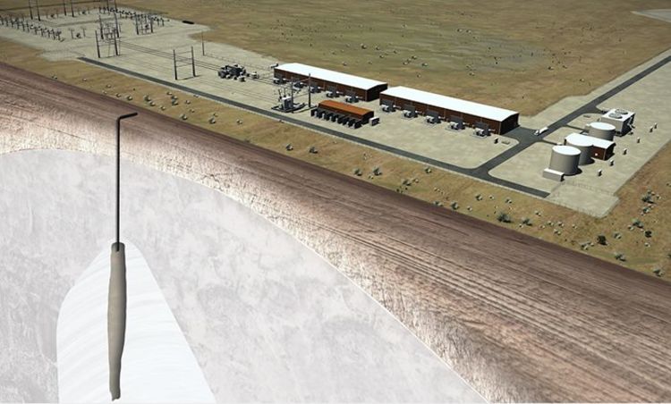

The ACES Delta project envisions producing up to 100 metric tonnes per day of hydrogen from water and renewable energy sources using a 220-MW alkaline electrolyzer bank manufactured by Norwegian firm HydrogenPro—one of the largest deployments of its type to date. ACES Delta will store that hydrogen in two gigantic solution-mined caverns sited in the only salt dome in the Western U.S, each of which can store up to 150 GWh of energy.

The storage facility will provide long-term seasonal energy storage to Intermountain Power Agency’s (IPA’s) Intermountain Power Plant (IPP) near Delta, Utah, a coal-fired plant that is slated to be repowered with two Mitsubishi Power advanced M501JAC power trains as an 840-MW combined cycle power plant by 2025.

Ducker noted ACES Delta had secured all major contracts, including for offtake by IPA, engineering, procurement, and construction (EPC) contractors, as well as major equipment suppliers, and operations and maintenance (O&M) providers.  Engineering giant Black & Veatch is slated to provide EPC services, while Mitsubishi Power will provide all hydrogen equipment integration, including the 220 MW of electrolyzers, gas separators, rectifiers, medium-voltage transformers, and the distributed control system. NAES Corp., an O&M service firm, will initially provide the O&M services for the plant and will oversee the current projected team of 20 plant-related personnel. WSP, another engineering giant, will provide EPC management services for the development of the two large salt cavern storage facilities, leveraging decades of experience in its development of more than 200 salt caverns around the world.
