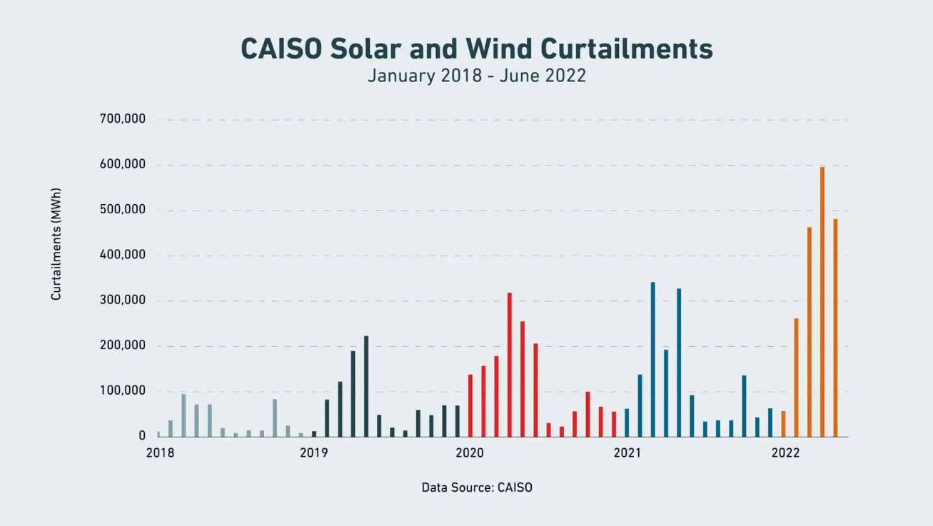

“In California, at just 30% renewable integration, there’s so much renewables overproduced in the winter and spring months that we’re shutting down these carbon-free resources in massive quantities,” says Michael Ducker, senior vice president and head of hydrogen infrastructure for Mitsubishi Power. “Meanwhile, we’ve seen energy shortages in the summer and fall months where we’ve had to rely on carbon intensive resources to keep the grid from blackout conditions. The solution to this involves shifting carbon-free overgeneration to seasons where we’re typically relying today on carbon intensive resources to keep a stable grid.”
In 2020 alone, the California Independent System Operator (CAISO) curtailed 1.5 million megawatt-hours of its utility-scale solar production, equivalent to 5% of total utility-scale solar generation. Operators have added renewables at a furious pace since then – and not just in California. Solar and wind accounted for roughly 90% of new electric generating capacity across the U.S. in 2021 and the first quarter of 2022, and the International Energy Agency projects that renewables will account for almost 95% of the increase in global power capacity through 2026. All told, the IEA expects grids to add 50% more renewable capacity between 2021 to 2026 than it did in 2015 to 2020.
Curtailment of renewables is the most obvious manifestation of the intermittency problem. The most compelling solution to manage intermittency while meeting rising electricity demand is to integrate a variety of storage technologies into the grid – and it’s a process that’s already underway.
Recent curtailments of solar and wind power in the California Independent System Operator (CAISO) region

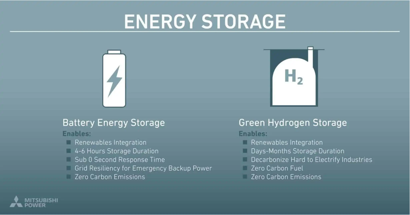

A New Framework for Thinking About Energy Storage
Storage options often are categorized as short duration (for example, batteries) or long duration (such as, green hydrogen). Batteries today generally offer four to six hours of electricity at maximum draw, although technological advances are likely to increase their duration rapidly in the coming years. By contrast, hydrogen’s ability to continue producing electricity is limited only by the volumes of the storage facilities that hold it.
Duration is a key consideration but characterizing storage options based primarily on that characteristic obscures important, potentially complementary distinctions. Storage technologies differ in other critical ways as well: reaction time, location, infrastructure, investment required, degradation, digital automation capability, security and more.
It may be more useful to characterize storage as centralized or decentralized rather than long or short duration. This distinction better captures the range of characteristics available among storage technologies and relevant for grid operators as they weave centralized and decentralized energy sources into cohesive networks that are resilient, flexible, responsive and valuable.
The key difference between battery and hydrogen storage
