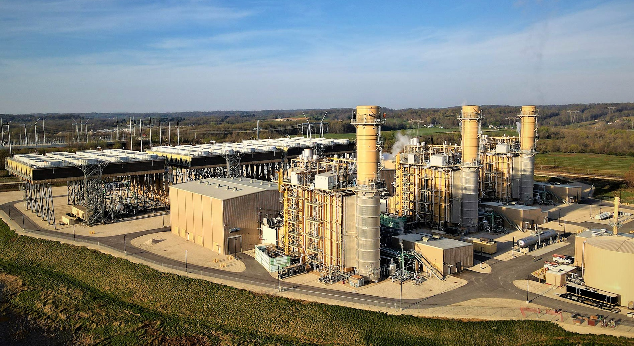

Officials said Guernsey, along with other planned electricity projects, could help alleviate concerns about resource adequacy and grid stability across PJM. The plant features advanced technology, including three GE Vernova 7HA.02 gas turbines (Figure 1) in a single-shaft combined cycle configuration. Officials said it’s the largest set-up of this kind at a U.S. gas-fired power plant.
1.         The Guernsey Power Station utilizes three GE Vernova 7HA.02 gas turbines in a single-shaft combined cycle configuration, the largest set-up of its kind in a U.S. power plant. Courtesy: GE Vernova
