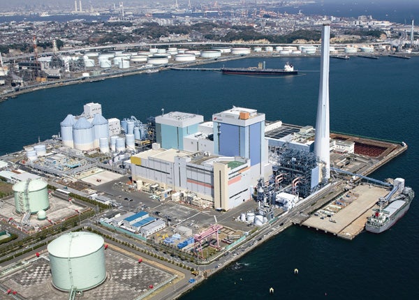

1. Best-in-class performance. The Isogo repowering project replaced two 265-MW conventional pulverized coal boilers and pollution control equipment (ESP and wFGD) with two 600-MW ultrasupercritical boilers fitted with ReACT advanced multipollutant controls. The newly repowered plant claims the title as the world’s lowest emissions-intensity coal-fired power plant. Design of the plant, located in Yokohama harbor, also considered plant aesthetics, including visibility of the stack. Courtesy: J-POWER
After operating Isogo for more than 30 years, EPDC (now J-POWER) committed to replace the plant and negotiated with the city of Yokohama for a major repowering project, which would more than double generation capacity at the site yet further reduce emissions with more stringent environmental controls. The J-POWER/Isogo repowering project replaced the two vintage coal-fired units while more than doubling the generation to two 600-MW units within the same site limits. J-POWER’s newly repowered Isogo burns low-sulfur coal and incorporates high-efficiency ultrasupercritical boilers, low-NOx burners and controls, primary SCR, electrostatic precipitators (ESPs), and ReACT (Figure 1).

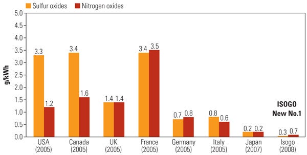

Today, Isogo ranks as the cleanest coal-fired power plant in the world in terms of emissions intensity, with emissions comparable to those from natural gas firing. Isogo typically operates in the single-digit ppm concentration range for SO2 and NOx (against Unit 2 permit levels of 10 ppm and 13 ppm), at less than 5 mg/Nm3 (0.005 lb/mmBtu) for particulates, and with well over 90% control of both elemental and oxidized forms of mercury (Figure 2).
2. Small environmental footprint. ReACT is a regenerative activated coke–based technology that produces saleable by-products (sulfuric acid or gypsum) and, as a dry process, does not require water. The technology should be of special interest to U.S. utilities burning lower-sulfur western fuels, especially at locations where there are significant water supply concerns. J-POWER reports that SO2 and NOx emissions at the Isogo plant are both at single-digit ppm concentration levels—emissions that are on par with a natural gas–fired plant. Data for Japan represent combined data for Japan’s 10 regional electric utilities and J-POWER. Figures for Isogo represent actual performance for fiscal 2008. Country figures represent combined emissions intensity for coal-, oil-, and gas-fired thermal power plants. Source: Federation of Electric Power Companies of Japan
