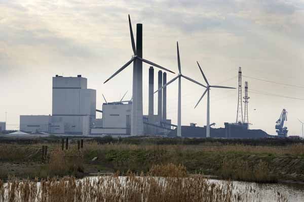

Vattenfall is one of the largest utilities in Europe and 100% owned by the Swedish state. Vattenfall is also the largest producer of thermal energy used for district heating in Europe and is dedicated to high-efficiency coal-fired power generation. One of its most advanced district heating plants in Europe is the Nordjylland Power Station, located in Denmark’s North Jutland region, near Aalborg (Figure 3). Vattenfall states on its web site that its ultrasupercritical (USC) Nordjylland Unit 3 is "the world’s most efficient coal-fired CHP plant." The plant sells its entire electricity production on the Nordic Power Exchange and more than 90% of its heat production to Aalborg District Heating Supply.
3. Efficient but expensive. Nordjylland Power Station’s USC Unit 3 is called the most efficient coal-fired CHP plant in the world by its owner, Vattenfall. A total of six supercritical and two ultrasupercritical plants call Denmark home. Each is configured to supply thermal energy for district heating systems. Even so, Denmark also has the highest household electricity prices in the EU, with retail rates surpassing $0.32/kWh, according to the U.S. Energy Information Administration. Courtesy: Vattenfall
Vattenfall makes its case this way: "Block [Unit] 3 has the world record in the use of fuel for coal blocks. But an efficiency of up to 91 percent by combined production and 47 percent [Editor: LHV-basis, 44.9% HHV — see the "Watch Your Terminology" sidebar] by clean electricity production using fuel about 20 percent better than older coal-fired plants." Later, Vattenfall goes on to state that "this is a world’s record that remains unbeaten." The 411-MW (384 MW net) Block 3 uses low-pressure turbine extraction steam to produce district heating water at 80C to 90C (176 F to 194F) by using a condensing heater. The double reheat USC plant fires bituminous coals sourced on the world’s markets.
