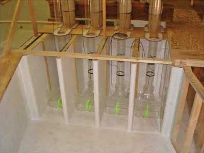

A physical model test program was used to ensure that the hydraulics of the actual lift pump station functioned properly. Model testing was conducted at Clemson Engineering Hydraulics (CEH) in Anderson, S.C.
The Oak Creek Power Plant Expansion Project model was built to 1:12 scale of the full-size pump station with all features, including four sets of FSIs and pumps (Figure 5). The model was tested for a variety of cases with varying flow and varying numbers of pumps in operation. It was also used to:
5.    Scale-model testing. An accurate 1:12 scale model was used to test and refine the hydraulic performance of the new intake system design. Shown is the lift station hydraulic model as viewed from the suction basin. Courtesy: Bechtel Power Corp.
  • Evaluate the suitability of the as-designed suction basin and determine if any approach flow anomalies could adversely affect lift pump performance.
  • Determine the impact, if any, of flow from the overflow weir introduced back into the suction basin.
  • Measure the head loss associated with the as-designed FSI.
  • Qualitatively observe the approach flow into the CW pump house to determine if any anomalies were present as a result of the new lift pump discharge configuration.
  • Test and document the approach flow conditions with the final as-tested design with modifications physically added to the model.
Overall, the as-designed suction basin and FSIs performed well. No problems with the approach flow to the CW pump house were identified. However, two hydraulic issues were observed for some testing cases:
  • Air-entraining surface vortices from the suction basin entering the FSI.
  • Flow separations within FSI after the sharp corners of the inlet.
To remedy the first problem, three vertical baffles combined with a surface beam were added in the basin upstream of the FSIs to eliminate air-entraining surface vortices. Addressing the second concern required rounding the edges at the FSI inlets to prevent flow separation at sharp corners. The final hydraulic model test documented that the lift station with these modifications functioned properly for all cases.
With the as-tested design validated by physical hydraulic model testing, modifications to the actual full-size lift pump station design were made prior to construction. By utilizing a physical model program of this kind, a hydraulically sound lift pump station design was achieved.
