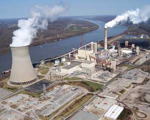

Duke Energy’s W.H. Zimmer Station (Figure 1) is a 1,300-MW coal-fired power plant located on the Ohio River at Moscow, Ohio. The unit entered commercial operation in 1991 and consumes approximately 3.8 million tons of coal annually. The U.S. Environmental Protection Agency required the Zimmer Station to remove a minimum of 91% of the sulfur dioxide (SO2) from the flue gas while not exceeding an emission rate of 0.548 pounds of SO2 per million Btu based on a 30-day rolling average.
1.    Powering Ohio. By making modifications in 2000 and 2007, the W.H. Zimmer Station in Moscow, Ohio, dramatically decreased the amount of scrubber by-product that has to be landfilled. Courtesy: Duke Energy
The station is equipped with a magnesium-enhanced wet flue gas desulfurization (FGD) system (scrubber) to control SO2 emissions. In 2000, the scrubber process was modified to accommodate a gypsum conversion process system to make high-quality synthetic gypsum that is sold to a wallboard manufacturer. Prior to the scrubber modification, scrubber by-products were landfilled at an average rate of 1.7 million tons per year. The 2000 modification cut the landfill rate by 77%.
