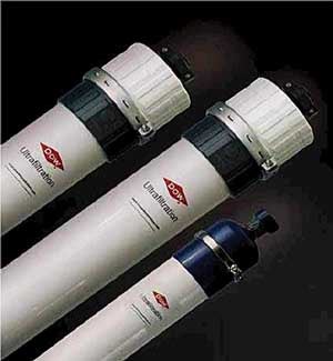

Reverse osmosis (RO) systems have become a favorite in more and more installations and are being successfully used with some very poor quality (high-turbidity, high-salt, high-organic) waters. The major equipment companies continue to improve RO and ultrafiltration (UF) systems, increasing the water production rates and reducing the equipment footprint (Figure 1).
1. Design changes. Dow claims that its new UF membranes can reduce the water treatment equipment footprint by 33%. Courtesy: Dow Water and Process Solutions

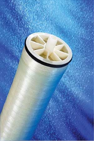

  4. Pushing the flux rate (or any other design parameter). RO membrane specifications have a recommended flux rate (gallons of permeate per square foot of available membrane surface area per day, or gfd). But this flux rate varies by the type and temperature of the water. The higher the operating flux rate, the higher the risk of fouling the membranes and the more often you will be cleaning them (Figure 2). Be conservative. Use the lower end of the recommended flux rate for your water source. Be sure to consider the flux rate at the lowest water temperature you are likely to encounter. A free software package for designing an RO system can be downloaded from the Dow website (www.dow.com/liquidseps/design/rosa.htm). Version 7 of the ROSA software was recently released. It is simple to use and produces a wealth of design information. Whether you are actually doing the design or simply trying to evaluate a number of design bids, the software can be very helpful.
    2. Improved membrane performance and longevity. The newest reverse osmosis membrane offering from Dow is the BW30HR-440i, which has higher production and decreased fouling potential. Courtesy: Dow Water and Process Solutions
