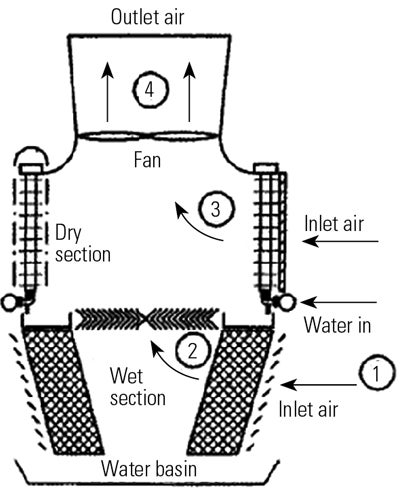

Plume Abatement. A plume is heated air and water vapor that exits the cooling tower. Under certain ambient conditions, the plume becomes visible when moist, heated air is cooled past its dew point. Its presence is a concern for many reasons, including the fact that the plume can be viewed negatively when the public associates it with stack emissions or nuclear power plants. The plume can also create dangerous fogging and icing conditions and must often be abated if the towers are located near airports or roads.
To combat these problems, plume-abated (PA) towers have been developed (Figure 6). To avoid creating a visible plume under certain ambient conditions, saturated air from the wet section is mixed with hot and dry air in the dry section of the tower. Because some of the heat in the incoming water is dissipated in the dry section, not as much cooling has to take place via evaporation in the wet section; thus, water savings can be realized with the PA towers. However, given the special constraints on the dry section, the savings potential is limited. The main purpose of PA towers, where the dry and wet sections are integrated in the same system, is to avoid a visible plume, and water conservation is an incidental consequence.
