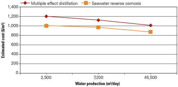

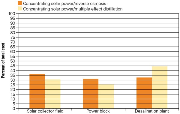

In evaluating capital costs as well as operating costs, one important criterion is the size of the solar field for each of the desalination technologies. Figure 9 provides a comparison of the relative costs of CSP combined with RO versus CSP combined with MED. It can be seen that the solar field as well as the conventional power plant costs are higher for the RO option, but the actual desalination plant cost is lower (see Trieb, referenced above). A comparison of the equipment cost for the desalination equipment alone is shown in Figure 10.
9.    Cost comparison between CSP and the RO and MED desalination options for major plant systems. Source: Bechtel Power
10.    Cost of desalination equipment. Source: Bechtel Power

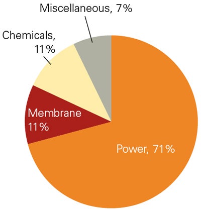

11.    Typical O&M cost for an RO desalination plant. Source: Bechtel Power
It is evident that the RO systems are less expensive for all sizes of plants. When compared with conventional systems, the viability of such solar desalination systems is dependent on the escalation of fuel costs, operation and maintenance costs of combined cycles, and market price for water. The operating costs of an RO plant, presented in Figure 11, indicate that the power is the most significant contributor (72%). For a desalination plant, a key factor in cost reduction is an increase in process efficiency by improving the recovery power ratio.
