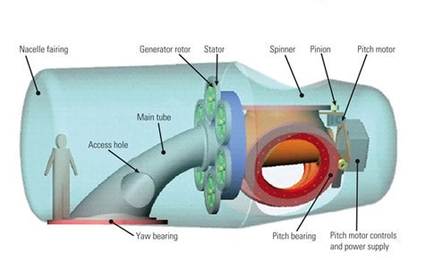

Wind turbine technology may be in the midst of a similar phase. Suppliers relatively new to the U.S. market, or with unique designs, are beginning to sell substantial numbers of machines. One supplier, with an innovative design consisting of multiple gears and permanent magnet generators (Figure 1), recently received orders for hundreds of this turbine. The confidence being expressed by the market in this design is rather remarkable, given that it is based on a single machine being demonstrated in Wyoming for less than two years.
1. Capacity from complexity. This multiple generator–drive machine, a significant design departure, has been ordered by the hundreds for commercial projects. It puts out two-thirds more power than the turbine currently dominating the U.S. market. Source: NREL Report No. CP-500-31178 (January 2002).
