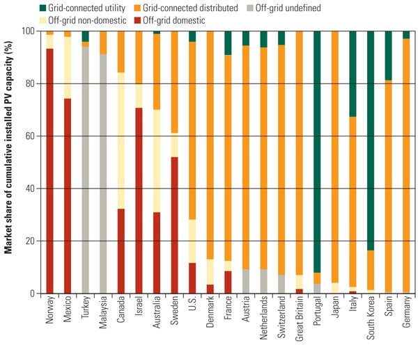

In her presentation, Kurtz primarily focused on the developing solar photovoltaic (PV) market. She pointed out that in the past the U.S. has mainly had a distributed market with little utility involvement. In contrast, Portuguese and South Korean utilities are very involved in using PV for electrical generation (Figure 1). Nonetheless, she emphasized that many predict that U.S. utilities are poised for large PV growth in the future.
1. Worldwide use of PV. The Jan. 2010 Solar Technologies Market Report shows that the countries on the right side of this graph have the highest percentages of grid-connected solar PV power. Source: U.S. Department of Energy’s Energy Efficiency and Renewable Energy Office
