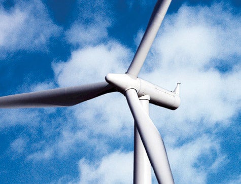

2. Big is beautiful. FPL Energy dedicated the third phase of the 735-MW Horse Hollow Wind Energy Center in Texas on October 19. It is now considered the world's largest wind farm. One hundred and thirty Siemens Power Generation wind turbines rated at 2.3 MW apiece, like this one, do the heavy spinning there. Courtesy: Siemens Power Generation
