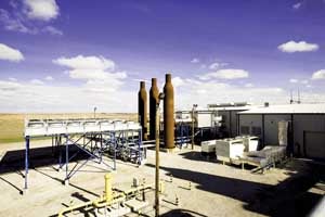

4. Plant back yard. The exhaust gases from each engine exit the building, pass through the selective catalytic reduction system, and then enter the stack. The rusted steel stacks are made out of Cor-Ten steel (A606), which forms a protective rust layer that provides excellent corrosion protection and never needs painting. The fin-fan cooling units, also supplied by Wärtsilä, use clamp-style fittings to connect all the cooling water lines and reduced field construction labor cost by 40%. Courtesy: Burns & McDonnell
