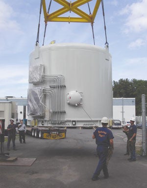

The 1-MW-class DFC1500 has been adapted from FuelCell Energy's standard, natural gas–fueled DFC module by adding the equipment and controls necessary to pretreat and handle unscrubbed digester gas. King County's South Wastewater Treatment Plant generates enough sludge to fuel 4 MW of DFC power plants.

3. A little to the right. Construction workers at the King County treatment plant maneuver a fuel cell fuel tank into place. All of the components were manufactured in Connecticut and then transported to Washington, where they were assembled.
