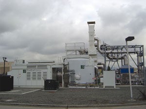

Courtesy: FuelCell Energy Inc.
1. Sludge power. This wastewater treatment plant in King County, Wash., is home to one of FuelCell Energy's 1-MW Direct FuelCells, which produces heat as well as electricity.

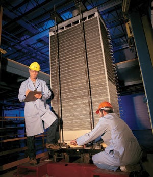

2. Checking it out. Technicians at FuelCell Energy's factory in Connecticut inspect a fuel cell module before it is shipped off to King County. Several modules are piggybacked to form a fuel cell stack—in this case, one with a generating capacity of 1 MW.
