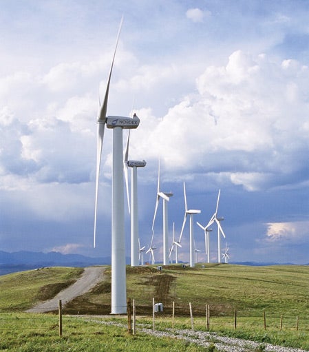

4. Canadian connection. Nordex Energy supplied 20 model N60 wind turbines rated at 1,300 kW for Canadian Hydro. The turbines, located in Pincher Creek, Alberta, near the Rocky Mountains, are equipped with special cold weather upgrades. Courtesy: Nordex Energy GmbH
