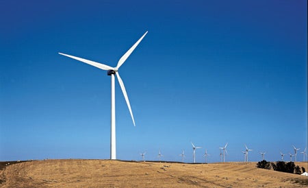

3. Perfect wind. Vestas supplied the ninety 1.8-MW turbines used by the High Winds Energy Center in the rolling hills of Solano County, 50 miles southwest of Sacramento. The plant is owned and operated by FPL Energy. Courtesy: Vestas Wind Systems A/S
