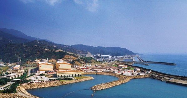

Most westerners are aware of the great pace at which China is building coal-fired plants. What is less well known is that China has put its nuclear power plans on a fast track, kicking off a construction frenzy worth billions of dollars. The latest government blueprints place China’s nuclear power capacity target at 70 GW by 2020—a nearly 50% jump from an earlier goal. That means the nation, whose 11 reactors (Figure 7) currently produce a combined 9 GW at capacity (or about 1.3% of the nation’s total power), must add about 44 new reactors by 2020—or four reactors every year.
7. Nuclear juggernaut. The 2,000-MW Guangdong Daya Bay Nuclear Power Station, built in 1994, was the first commercial nuclear power station on the Chinese mainland. To increase power supply and meet environmental goals, China has fast-tracked nuclear power plant construction, working to increase installed nuclear capacity to 70 GW by 2020, and possibly 200 GW by 2030. Courtesy: CLP Power Hong Kong Ltd.

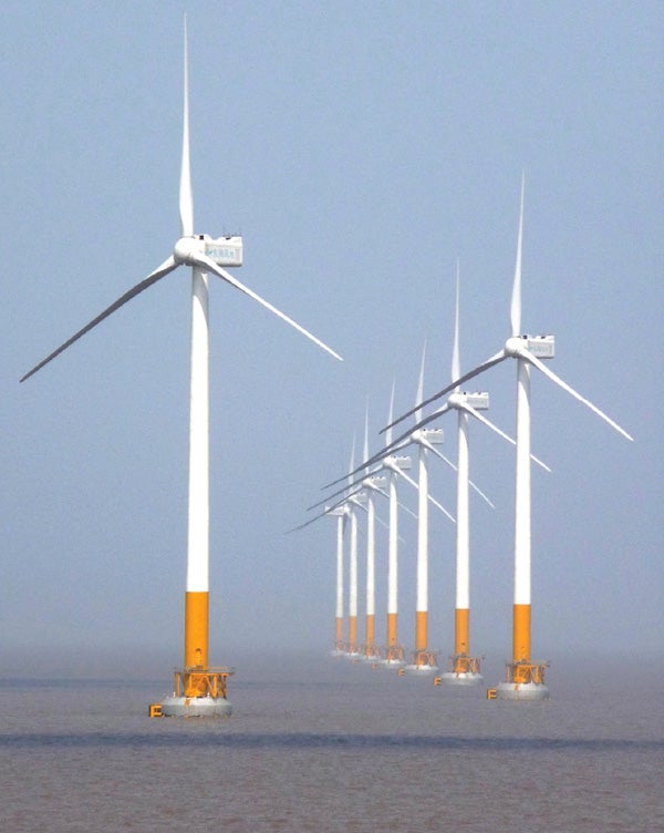

At the same time, the country is steaming ahead with offshore developments. In June 2010 it was scheduled to begin operating the 102-MW Shanghai Donghai Bridge offshore wind farm (Figure 8)—not just the country’s first offshore project, but also Asia’s first, and the first outside Europe. With a coastline stretching 18,000 km, China isn’t stopping there: Four more offshore wind projects with an estimated combined capacity of 1 GW are being prepared for bidding.
8. Coastline power. The Shanghai Donghai Bridge Wind Farm, China’s first offshore wind farm, uses 34 Sinovel SL3000 (3-MW) wind turbines. Each SL3000 contains a set of core electrical components from American Superconductor Corp. Courtesy: AMSC
