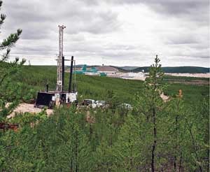

Cameco operates the McArthur River mine, the world’s largest uranium mine (Figure 6). McArthur River started production in late 1999 and is known to have enormous high-grade reserves. Areva Resources operates the McClean Lake Mine, which also started production in mid-1999. Both McClean Lake and McArthur River mines have achieved ISO 14001 environmental certification.
6. Uranium strike. Located in northern Saskatchewan, the McArthur River mine has the world’s largest, high-grade uranium deposit. Courtesy: Cameco

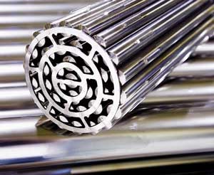

Because of the CANDU reactor technology, Canada does not have to enrich uranium. CANDU fuel bundles contain either 28 or 37 rods of tubular zirconium alloy sheaths with UO 2 pellets inside, each rod being about 50 cm long (Figure 7).
7. Bundle of energy. A fuel bundle used to generate electricity in CANDU reactors. Courtesy:Cameco
