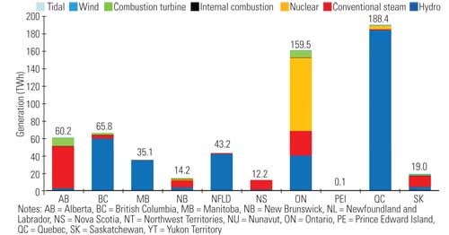

Canada is a federal state, comprising 10 provinces and three territories. The federal government is responsible for international and inter-provincial issues. But unlike U.S. states, provincial governments are given significant authority by the Canadian Constitution to manage electricity and natural resources within their borders. Hence, the Canadian electricity industry is strongly organized along provincial lines, and individual provinces have significantly different views of energy policy (Figure 1).
1. Provincial differences. In 2008, Canada generated a total of 598.8 TWh. Alberta, Ontario, and Saskatchewan are typically Canada’s three largest users of fossil fuels for the production of electricity. Overall, Alberta used 51% of all coal and 42% of all the natural gas consumed in Canada for the production of electricity; Ontario consumed 24% and 32%, respectively; Saskatchewan consumed 18% and 10%, respectively. Québec generated 30% of Canada’s total electric power and approximately 50% of all hydroelectric power while using about 1% of total fuels consumed for other forms of electricity production. Source: Statistics Canada
