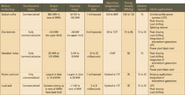

If you're responsible for T&D system planning and are ready to begin considering energy storage a viable option, the table and the accompanying box are a good place to start. The table summarizes the status of and future prospects for several battery technologies that either currently offer bulk energy storage capability or promise to do so in the near future. The following discussions and case studies explain how the new bulk-storage batteries work and how pioneers are using them to solve a number of common T&D problems.
A comparison of today's bulk electricity storage technologies
Source: Platts
