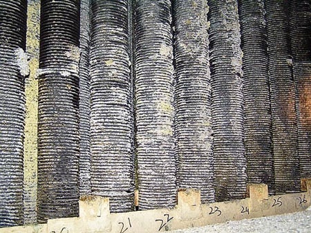

Using nondesign fuels can significantly increase the potential for gas-side problems, such as corrosion and deposition. Burning fuel oil in duct burners raises radiation heating and the potential for hot spots and liner damage. For example, stress-corrosion cracking of cold-end preheater tubes has become more prevalent. Although burning even clean natural gas can produce the phenomenon, burning fuel oils and gasified fuels raises the risk of occurrence. Figure 9 shows the deposits on the preheater tubes of a plant that burns a low-Btu, high-H2S gas.
9. Asking for trouble. Preheater deposits caused by burning low-Btu, high-H2S gas. Courtesy: Tetra Engineering

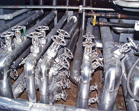

For the other components of a combined-cycle plant, the greatest risk of an extended lay-up has been localized freezing, if the plant is in a cold climate. Many plants in extended lay-up have seen their tubes, headers, and piping freeze. Sometimes the damage was not immediately apparent and was discovered only during subsequent start-up. Figure 10 shows an area of economizer drains that is very difficult to protect from freezing.
10. Drains not in Spain. Components at high risk of freezing, such as these drains, must be identified and protected during extended lay-ups. Courtesy: Tetra Engineering

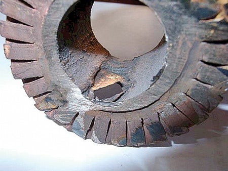

Many combined-cycle plants now take their cooling water from lower-quality sources, such as processed municipal wastewater, agricultural run-off water, or brackish wells. This makes it more difficult for the facility's water treatment plant to provide adequate supplies of water at various qualities to meet operating needs. Water treatment difficulties have increased waterside contamination and corrosion in evaporator tubes at several plants. Figure 11 shows underdeposit corrosion damage to the tubes of a high-pressure evaporator.
11. Hidden problem. Underdeposit corrosion damage in a high-pressure evaporator. Courtesy: Tetra Engineering
