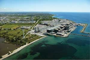

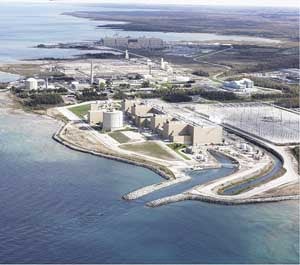

  • Ontario Power Generation owns Pickering Units A1 and A4 – A8 (Figure 3) and Darlington Units 1 – 4; Bruce Power owns Bruce Units A3 and A4 and B5 – B8 (Bruce A1 and A2 are being refurbished, with an early 2010 restart date) (Figure 4).

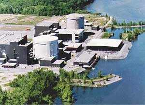

  • Hydro Québec owns Gentilly 2, a plant that has particular importance for grid stability and provides electricity during periods of low hydroelectric generation (Figure 5).

3. Pickering Nuclear Generating Station. The Pickering Station, at over 4,100 MW, is one of the largest nuclear plants in the world and uses the CANDU nuclear reactor. Courtesy: CANDU Owners Group Inc.
4. Bruce Nuclear Generation Station. This eight-unit nuclear plant was constructed in stages between 1970 and 1987. Bruce Nuclear Generating Station is the largest nuclear facility in the world, with a total output of over 6,200 MW, and is the only nongovernment-owned nuclear plant in Canada. Bruce A1 and A2 are currently being refurbished. Courtesy: CANDU Owners Group Inc.
5. Gentilly Nuclear Generating Station. Gentilly was constructed in stages between 1966 and 1983. Unit 1, a prototype CANDU reactor, is being decommissioned. Unit 2 has a net output of 638 MW. Courtesy: CANDU Owners Group Inc.
