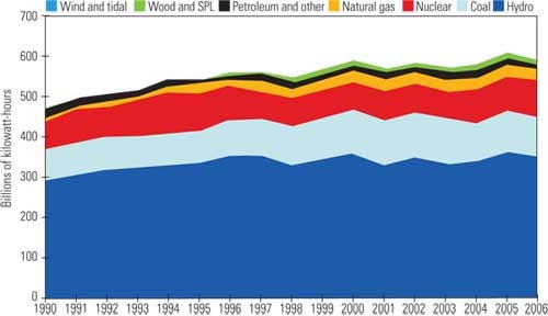

Hydropower plays a significant role in Canada’s electricity supply profile, accounting for 61.7% of its electricity supply and nearly 100% of its generation from renewables, according to Statistics Canada (Figure 2). Canada’s total hydroelectricity supply is second in the world to China’s. Some 25% of Canada’s energy demand is met by hydropower, compared to 3% for the U.S.; the balance, 34%, is exported to the U.S. The majority of Canada’s hydroelectricity is produced in Québec, British Columbia, Newfoundland and Labrador, Ontario, and Manitoba.
