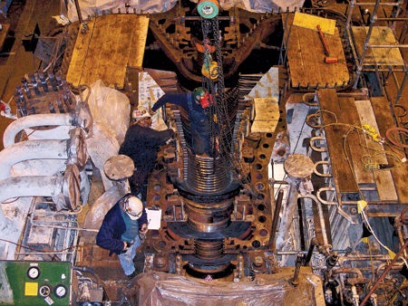

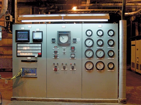

On the electrical side, Phase I work included replacing 50% of the turbine's rotating blades and making extensive repairs to its stationary blading and seals (Figure 3). New turbine supervisory instrumentation (Figure 4) enables plant operators and engineers to better analyze and correct vibration and bearing temperature problems.
3. Turbine on the half shell.
Each of the steam turbines was overhauled as part of the repowering project. Courtesy: Exelon Corp.
4. New reliable. The plant upgrades included a new turbine supervisory control system. Courtesy: Exelon Corp.
Exelon Power recently completed Phase II of the upgrade project. During a planned outage, about 80% of the turbine's rotating and stationary blading was replaced. The turbine supervisory instrumentation system also was rewired and equipped with new control panels.

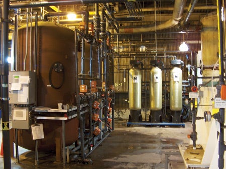

Finally, Fairless Hills Generating Station also got a new boiler water treatment plant (Figure 5) with a capacity of 150 gallons per minute. The old plant, which needed significant repairs, also ended up oversized when USX decided to shut down the steel mill, which had been receiving steam from the power plant.
5. Scaled down. A new water treatment system helps keep the boilers at Fairless Hills free of deposits. Courtesy: Exelon Corp.
