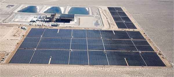

1.    Desert denizens. Sempra’s El Dorado Energy consists of a 480-MW gas-fired combined-cycle plant and a 10-MW photovoltaic (PV) plant. The PV portion of the plant was designed in 1-MW blocks that terminate at one of the 10 small white buildings that contain the panel terminations, two inverters, and a transformer to produce electricity at 4,160 V. All the electricity produced by the plant is then terminated in the switchgear at the power plant. Courtesy: Sempra Generation

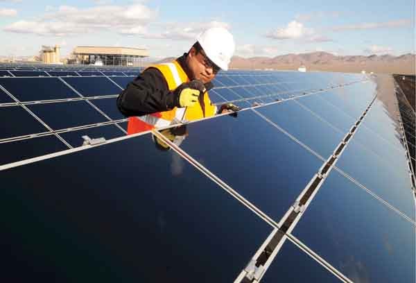

2.    One-man show. Only one member of the El Dorado Energy plant staff is assigned full-time PV system responsibility. Courtesy: Sempra Generation
