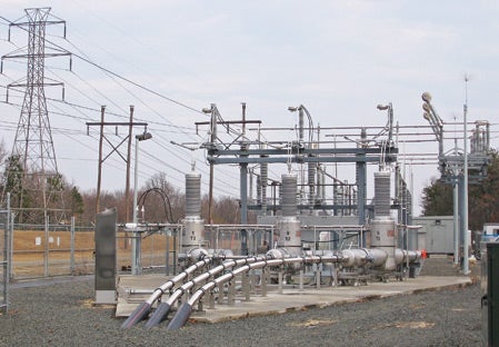

The world’s first high-temperature superconductor (HTS) power transmission cable system in a commercial power grid was energized in April and is operating successfully in Long Island Power Authority’s (LIPA) Holbrook transmission right-of-way.
The cryogenically cooled 138,000-V system consists of three individual HTS power cable phases running in parallel and is capable of transmitting up to 574 MW of electricity at capacity. Its 2,000-foot-long cable system contains hair-thin, ribbon-shaped HTS wires that conduct 150 times the electricity of similar-sized copper wires (Figure 4). This power density enables transmission-voltage HTS cables to use far less wire and yet conduct up to five times more power—in a smaller right-of-way—than traditional copper-based cables. And unlike conventional power grids, which typically lose 7% to 10% of power due to the inherent electrical resistance experienced with copper wires, HTS cables transmit electricity with virtually no electrical losses.
4. Hot transmission.
LIPA’s 574-MW high-temperature superconductor power transmission cable system consists of three cables running in parallel in a 4-foot-wide underground right-of-way. The three cables shown entering the ground can carry as much power as all of the overhead lines on the far left. Courtesy: American Superconductor Corp.
LIPA is the third electric utility in the U.S. to have deployed an HTS cable system in its power grid. In the summer of 2006, National Grid and American Electric Power energized distribution-voltage HTS power cable systems in Albany, N.Y., and Columbus, Ohio, respectively. At nearly half a mile in length, LIPA’s HTS cable system is the longest of the three. It also is the first to operate at transmission voltages. After an initial operational period and following performance and economic reviews of the cable system, LIPA plans to retain the new superconductor cable as a permanent part of its grid.
HTS power cables are envisioned by the DOE as a component of a modern electricity superhighway—one that is free of bottlenecks and can readily transmit power to customers from remote generation sites, such as wind farms. The DOE previously funded $27.5 million of the $58.5 million total project cost as part of its ongoing efforts, through the Office of Electricity Delivery and Energy Reliability, to modernize the nation’s electricity delivery infrastructure.
