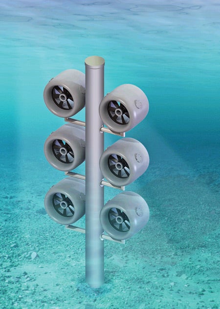

Free Flow Power Corp. (FFP) has developed a hydrokinetic turbine generator system that extracts energy from moving water without requiring the construction of new dams or diversion. The company wants to submerge the system, which can be installed in an array of different configurations to suit site conditions, in the Mississippi, Missouri, Ohio, Niagara, and Detroit Rivers (Figure 4).
4. River current. Free Flow Power Corp., a hydrokinetic energy firm, has filed more than 100 projects with the Federal Energy Regulatory Commission to install its turbine generation system in major U.S. rivers. The turbines can be arranged in arrays to suit site conditions. Courtesy: Free Flow Power Corp.

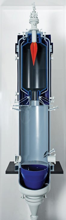

The gasifiers, which are 59 feet long with an inside diameter of about 10 feet, weigh 220 tons and are capable of gasifying up to 2,000 tons of coal daily. Gasification takes place in a cylindrical reaction chamber at temperatures above the coal-ash fusion temperature. Finely ground fuel that is introduced with a mixture of oxygen, and steam via a burner at the head of the reactor is converted within a few seconds into raw syngas consisting mainly of carbon monoxide, hydrogen, carbon dioxide, and water (Figure 5).
5. Coal gasifier. As recently delivered to a coal-to-polypropylene plant in China, Siemens Energy’s newest 500-MW gasifier is capable of gasifying 2,000 tons of coal daily. Finely ground fuel introduced via a burner at the head of the reactor is instantly converted into raw syngas. Solidified clinker granules can be removed via a material lock at the foot of the quenching chamber. Courtesy: Siemens

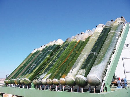

APS and GreenFuel partnered in 2005 and recycled 80% of daytime carbon dioxide emissions from APS’ 1,040-MW gas-fired Redhawk Power Station using an algae bioreactor. The contraption was simple: Carbon dioxide emissions coming out of the stack were directed through specially designed pipes and into specialized containers holding hungry algae. In the presence of sunlight, the algae consumed the carbon dioxide (Figure 6). GreenFuel then converted the carbon-rich algal biomass into transportation-grade biodiesel and ethanol.
6. Hungry critters. An algae bioreactor system connected directly to the stack of APS’ 1,040-MW Redhawk Power Station successfully recycled greenhouse gases into renewable biofuels in 2006. Courtesy: APS
