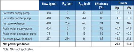

Although a sustainable dilution rate for osmotic power membranes is unknown, a 45% dilution rate is assumed in the following analysis, based on a typical recovery rate for SWRO. Assuming a turbine flow rate of 367 gpm, water salinity of 37,000 ppm, and the membrane, pump, turbine, and ERD performance characteristics listed above, an osmotic power system will indeed produce positive net power (Table 3).
Table 3. Projected high-efficiency osmotic power system performance (base case: fresh water/seawater). Source: Energy Recovery Inc.
If the membranes perform at the highest specific energy recorded in the demonstration tests, more than 308,000 ft2 would be required to generate the net power shown in Table 3. If membrane-specific energy could be increased to 6 x 10-4 hp/ft2, for example, the required membrane surface area could be reduced to 94,000 ft2.
