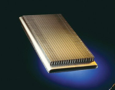

The ACC (Figure 4)—from SPX Cooling Technologies of Bridgewater, N.J.—uses twenty-four 200-hp single-speed motors for cooling the 272 primary heat exchanger bundles and eight 200/50-hp dual-speed motors on the 48 secondary heat exchanger bundles that optimize condenser vacuum over the range of normal plant operating conditions. Seven-bladed aluminum fans of 32-ft diameter blow 1.6 million lb/hr of ambient air across the 32 modules, enough to condense the almost 1.1 million lb/hr of exhaust steam that enters the ACC through a 20-ft diameter duct.
4. Compact surfaces. The air-cooled condenser used at NYPA Astoria has 10 million square feet of single-row condenser tubes, enough to condense over 1 million lb/hr of exhaust steam. Courtesy: SPC Cooling Technologies
