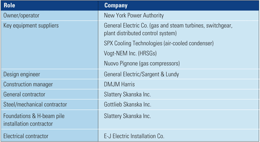

NYPA Astoria's project team. Source: New York Power Authority
Project overview
The Astoria project team (see table)—consisting of NYPA, Skanska USA Civil Inc. (through its subsidiary Slattery Skanska), New York–based DMJM Harris, and General Electric/Sargent & Lundy—was responsible for the overall permitting, design, procurement, and construction of the plant. A key task was the erection of a 97,000-square-foot, two-story main building—topped by twin 240-foot-tall stacks (Figure 2)—to house the power block.

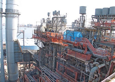

3. Steamy side. Vogt-NEM supplied the HRSGs for the NYPA Astoria combined-cycle plant. Courtesy: Slattery Skanska
